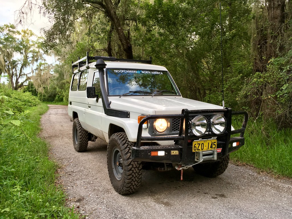

I fitted a eBay one to my troopy. I went with the one that looks just like stock, but is one piece instead of having that joint there. Fit well and it was cheap. I wouldn't trust it for deep water, but for dust it works great.
Untitled by CA18 Sean, on Flickr
Is that a Western Australian number plate?
I expect water crossings in the future so a one piece is preferable. ca8sean, what makes you say you wouldn't trust it in water? One piece and sound connections should suffice, no?
