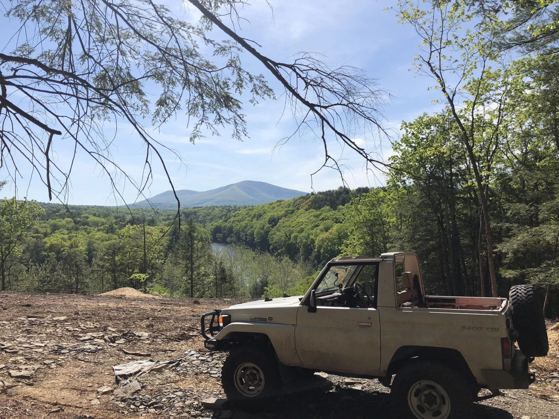

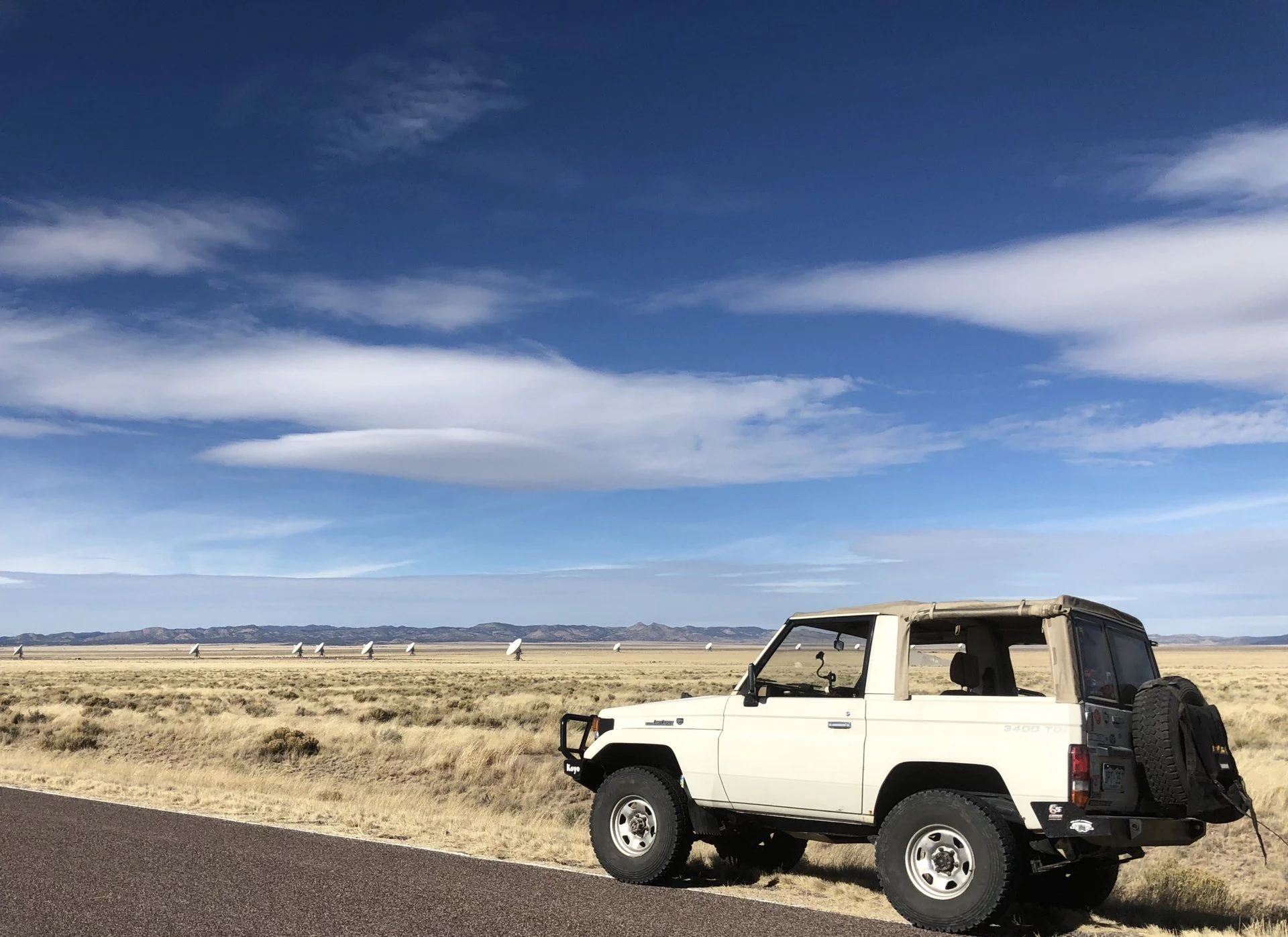

I have 2 sets of rims:
70 series 16" steelies: Toyo M55's in a 255/85/16 flavor (I run these with and without spacers):
And 80 series 16x8 steelies with Toyo MT 285/75/16's (with 1.5" spacers):
