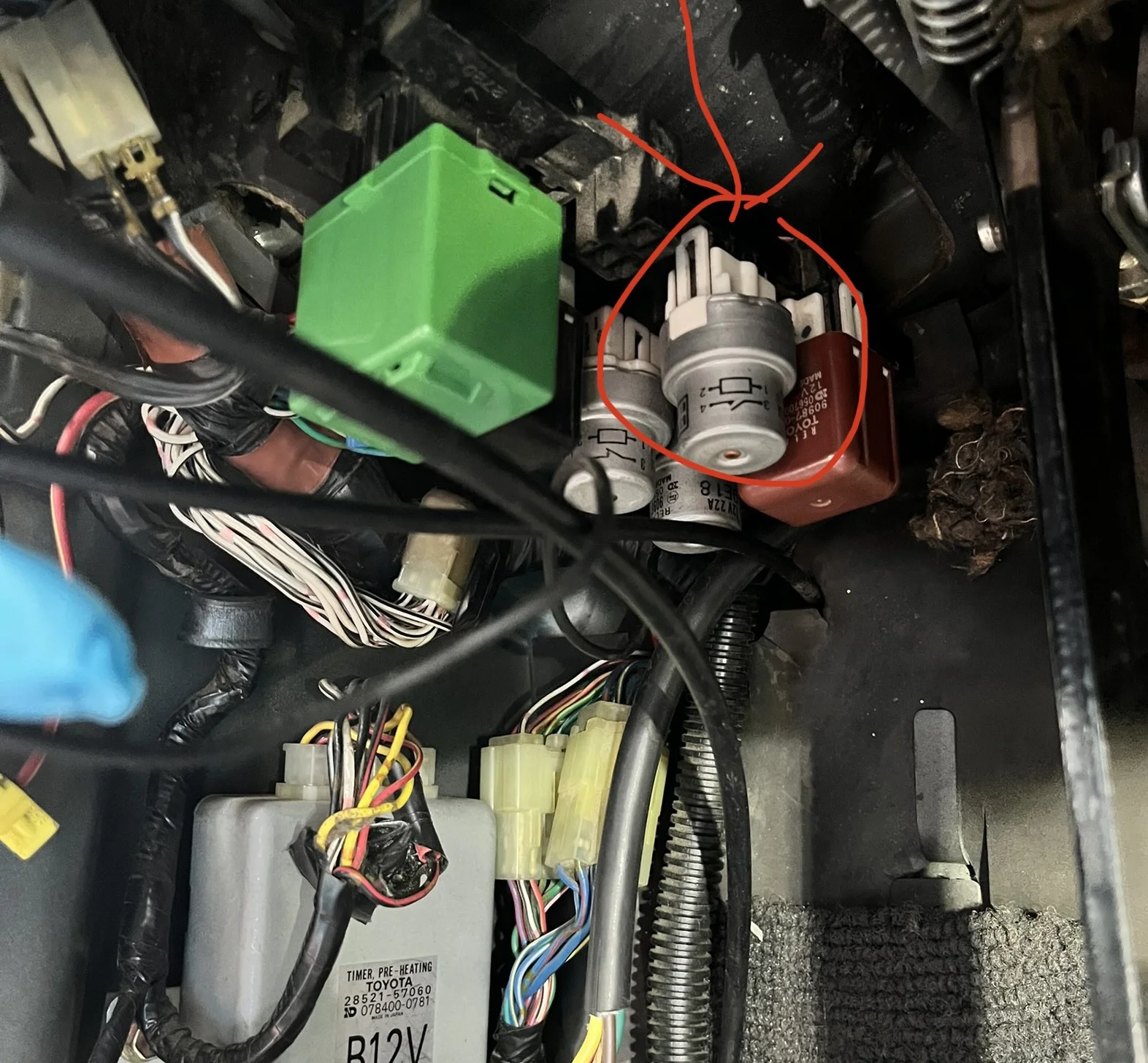

After hours of troubleshooting, going through wire looms, fixing frayed wires, making new grounds, etc I found it was this relay. when it would heat up (it’s been around 100 degrees here) and the engine was warmed up, if I had the fan, lights etc on it would make this relay trip. Got so bad I couldn’t drive with any electronics on.
I found it on accident actually, just starting looking and bumped it.
but surprisingly I found a replacement at autozone for $20. Swapped them out and now my shut down problems are gone.
hope this helps someone
