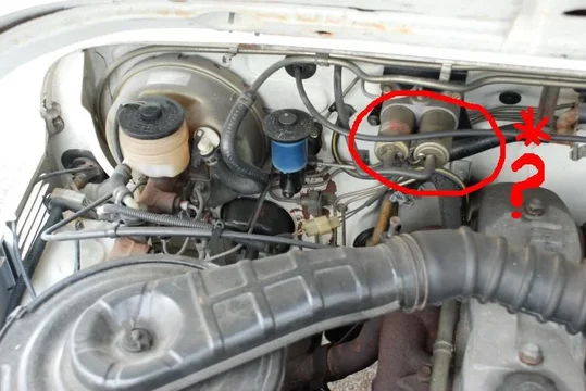

I've got to throw some pics of your engine bay in here:
But what are those cylindrical thingies to the left of your clutch master on the firewall?

haha, eeeehhhh good question.... :rolleyes:
since the engine is running soooo nice and quiet, i mainly focused on the body and not the engine..
the whole engine thing is a new to discover area for me so at this moment I kinda look with a blurred view to every part underneath the hood... :) all impressive tubes and cilinder shaped thing under there... but what they do.. for most of them i have no idea.. :confused:
I seen this on a rig from Japan and the owner responded and said that was the vacuum activater for the 4WD???
R
R
then that might have something to do with the F.D. knob on my dash? still have to find out how and when i use that one... all instructions are in jananese.. :):grinpimp:
