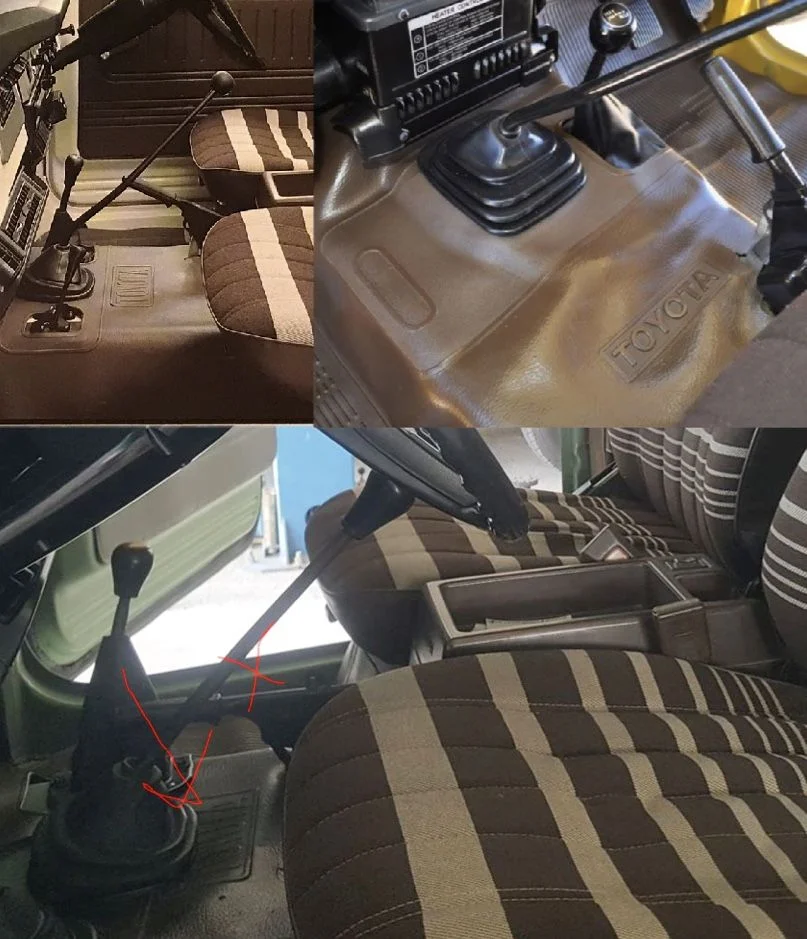

Has anyone bought or have any expertise with a BJ44? I have a BJ40, but buying a BJ44 and not sure what to check to make sure it's stock. The year is 1982, it has Zebra Stripes seats and engine is 2B. I thought I'd start this conversion for anyone interested or can help.

The best way is to make many photos. Starting from VIN plate, engine, interior in details, from different sides and under.
Color at least doesn’t look original.
That is not stock. Never seen a stock three wiper LHD windshield. Heard of someone custom making one. Thought the 2B was a JDM engine. The headlight guard seen on special edition JDM 40 series.
@Living in the Past: what's your clue that this is LHD? I downloaded the picture and cranked up the brightness but still could not see a steering wheel inside.
I, too, thought 2B was a JDM-only option, and I've only ever seen those side-view mirrors on JDM trucks. OP mentions zebra-striped seats, which were typically associated with LX models, which would comport with your mention of the headlight guards on special editions.
I just assumed that this was an RHD truck.
That's what I was wondering about with respect to having 3 wipers. It is imported from Japan, was originally a RHD, but converted to LHD using original BJ40 series gearbox.

Wiper motor on the right would be a LHD.
The zebra strip interior was common on JDM mid wheel base vehicles. They didn't get the LX designation like SWB.
How about VIN plate? It will say a lot
Up to now:
There is no 2B LHD
There is no BJ44 LHD
There is no Hard top on medium wheelbase LHD
There is no triple wiper LHD
There is no side mirrors such type on LHD
VIN plate please
Ok. I noticed that location but I wasn’t familiar enough with the 3-wiper setup to know that it wasn’t different from 2-wiper setups like my RHD HJ47 with wiper motor on left.
You’re right, I forgot that.
OP mentions that this has been converted to LHD, which to my mind pretty much throws out the question of “what is stock?”
Assume they kept the RHD cowl and dash and switched instrument cluster and glove box. The insert dash started 10/81 on RHD and 10/82 on LHD. The pre 1/79 seam in the rocker is a mistery.

Unfortunately there is no evidence in the catalogue that Toyota made the plastic top for BJ43 in Europe. I can provide part numbers for the winch, Roll bar, for the rear heater, even for different tires, but the soft top is the only top for BJ43 in Europe. If we cannot find any picture or part number in the original Catalogue than it was a dealer option but not Toyota (in Switzerland for example it was option with the Warn Hubs, different front bumper with the Warn winch or Vestfalia towing hook - all these were on the new cars but from the dealer).
It's more than possible that sometime after leaving the factory, items were added/changed to suit a previous owner. An interesting series of holes in the face of the front bumper. That rocker seam might be part of the attachment of a replacement cowl/firewall.
Yes, for historical investigation, a VIN plate might be instructive along with a photo of the stamped frame serial number.
Unless someone is concerned about absolute originality, this one is no more modified than many other Land Cruisers out there. If the seller however is representing this as a 100% original Toyota factory creation, valid documentation and detailed examination would be needed for authentication.
