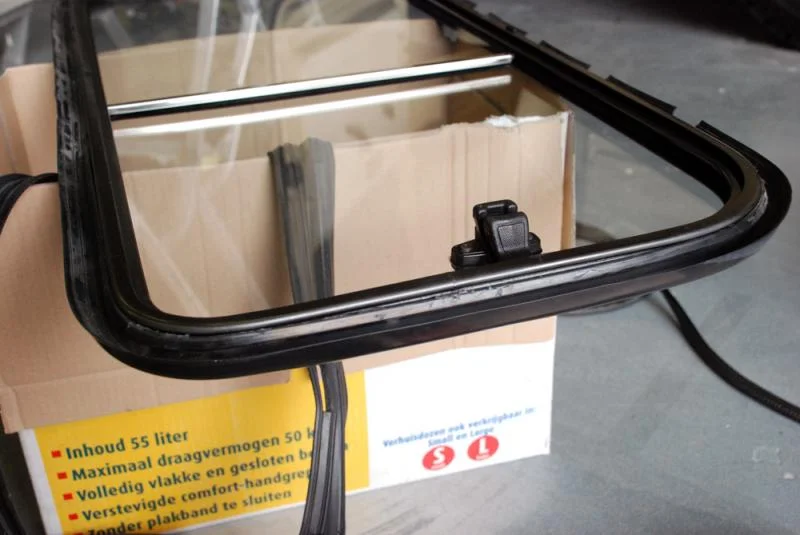

attachment.php
Folkert, did you actually install the window after first fitting the outside weatherstrip/rubber as shown in this picture or did you first glue the windo only, thereafter installed the pinchweld on the inside and lastly the outside rubber at the end ? :confused:
the correct order should be (assuming the window frame is removed from the hardtop , and the glass is removed from the frame):
a. install the felt run weatherstripping in the frame
b. install the glass in the frame
c. glue/kit the outside rubber on the frame
d. glue/kit the frame into the hardtop opening
e. finish by using a U-profile (with metal core) to connect the frame with the hardtop metal
you can see the procedure on my blog, starting with this post where you can see what weatherstripping i used:
Sliding window weatherstripping bj44
then how i installed the felt window run and glass:
Installing window weatherstripping bj44
and finally glueing the outer rubber on the frame, , then the frame into the hardtop, and finish with the U profile:
Install sliding windows bj44
good luck!!!:D
Thanks for the info, much appreciated! (as my outer rubbers were never glued to my frames) :cheers:
