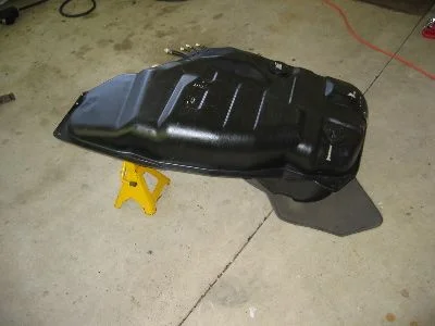

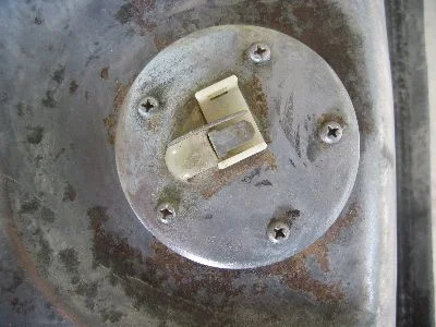

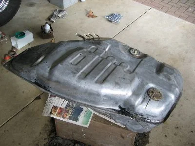

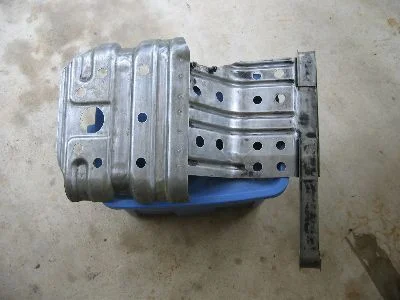

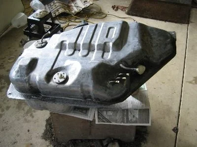

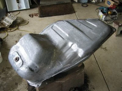

Here's some pictures of a tank from a 09/1980 BJ-42 to compare with yours.
ie. location of the fuel return, location of the drain on tank and matching hole on the skid-plate.

On my diesel tank (BJ42), the metal cap that attaches to the top of the tank with screws and has the electrical plug for the fuel level) actually has 'FJ40' stamped into it.

funny mis-labeling and painted tank.

the tank got scraped (IH8UNDERCOATING), wire-wheeled, sanded, Rustmort'd, self-etching primer, then three coats of ZeroRust. If done over, I'd pass on the ZeroRust. I wasn't very impressed with how long it took to harden (the POR-15 on my frame was harder in 4 hours than the ZeroRust after a few months), and still never approached POR for durability. Oh well, chalk this one up for experience.
Next time:
I'd be interested to try the POR Metal Prep to compare with the RustMort. I'd use POR again (very worthwhile even considering the price difference between tremclad, etc), but would also like to try RustBullet (looks worthy of a test).
