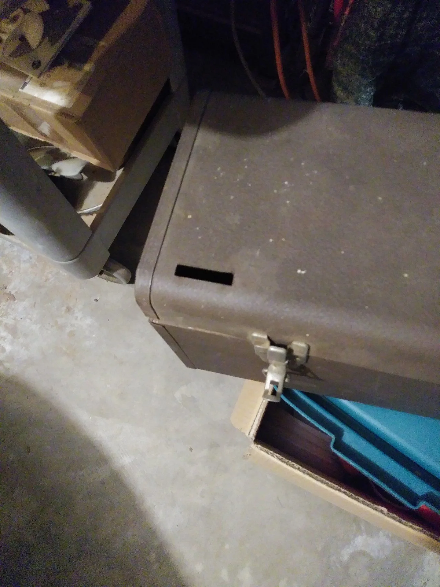

It's happened a couple of times now, so I gotta ask.
First time was a plastic (ABS?) large storage box. It had a couple of big holes for electric outlets. I plugged them with a piece of plastic sheet, some sealant and a few small bolts at the corners. Basically what I had on hand. It's probably weatherproof now. But not very happy with the results honestly. It looks bad, the patch and bolts/nuts stick out and catch on things. Works, but not great. No pride of accomplishment on that one, sorry to say.
Now, I just got a carry metal tool box. It also as a largish (3/8 x 1.5") slot in the top as well as a few holes. I want to fix that so I can leave it outside if need be. The small holes I can probably fix reasonably well with a rubber washer and small bolts, or a plastic plug. The slot is harder. Of course, I could weld it shut with a patch and repaint it all, but can't do that now. So have to improvise something else. But I'd rather not have it be another half-@ssed job like the earlier one.
Thoughts on the better way to do something like that? So it looks OK and does not create issues catching on stuff. A thin metal patch with some super duper glue in the back? Epoxy with a backing of sorts? Plastic or metal insert? (and yes, I know, everything is better with duct tape but I'm gonna go for a bit more of a permanent solution this time...)
Any suggestions? TIA

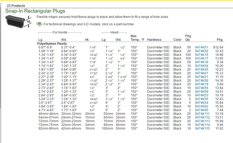

Mcmaster has various sizes of these. They are plastic, not rubber, but maybe they will seal OK with a good amount of silicone caulk. Some cutting/enlarging may be needed, though.

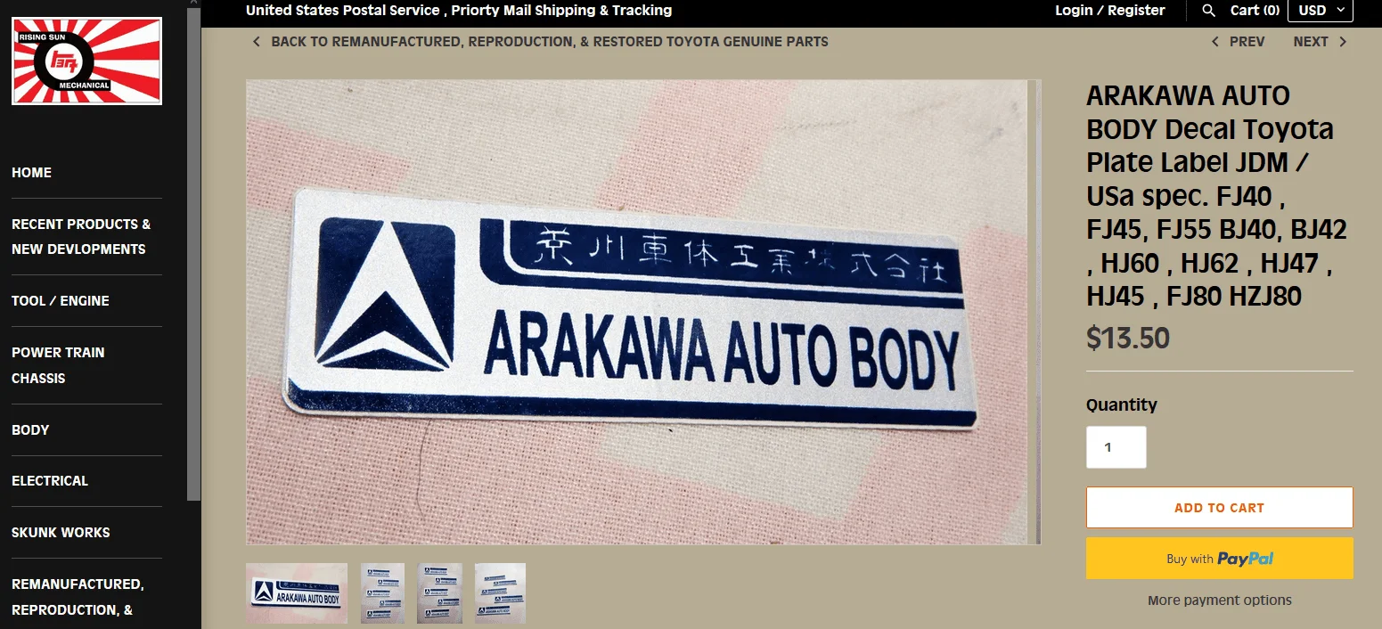

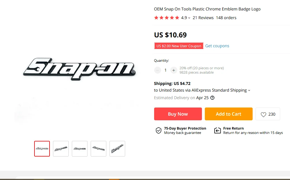

another idea would be to get an adhesive "plate" and stick it on. IDK, but maybe @ToyotaMatt has something. His metal VIN plates may be too expensive for this application, but maybe something like this
aah, some good ideas there. In my antique set ways, I did not think about making this an esthetic enhancement rather than a mere less-sucky-if-at-all-possible approach. And, of course, making fun of Snap-on addicts, say, is always a plus... :)
Dang, I also did not really think about enlarging the hole to make it easier to patch, rather than just patching what's already there. That's creative thinking, all right.
