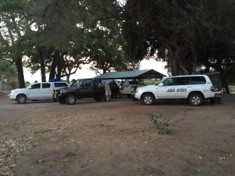

I usually run 25psi as stated on my tyres, but dropped to 15psi for the washboard and it made a nice difference, no issues with the bead coming off and the 2 hours of washboard were generally ok, speed was about 100km/h on the washboard, any less than 80km/h was very unpleasant and some loud pinging from steering column hitting the steel tube in the dashboard
4 yota's, most common vehicle in the valley is a Landcruiser, and most hunters use the 70 series, & fishermen the 100 series
