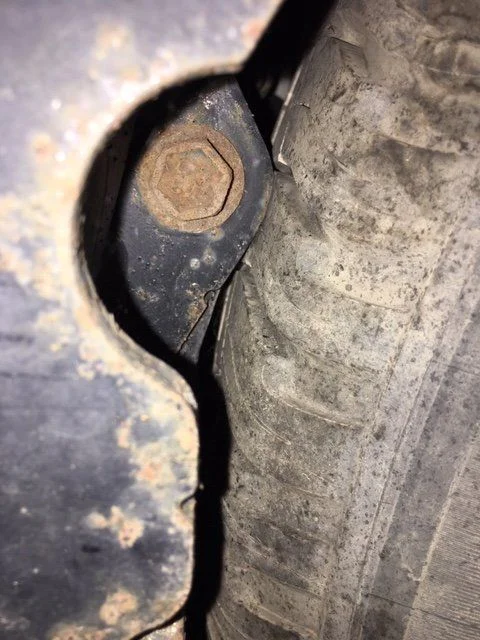

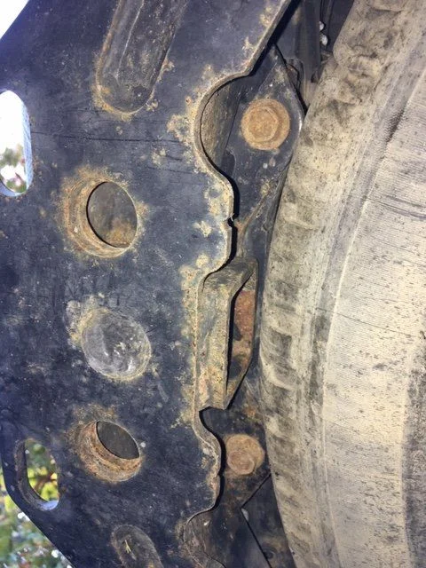

It hits both the inside edge of the hitch receiver and the sway bar. But not a big deal as I have ordered a spare tire carrier and I am planning to put an auxiliary fuel tank in the spare location.

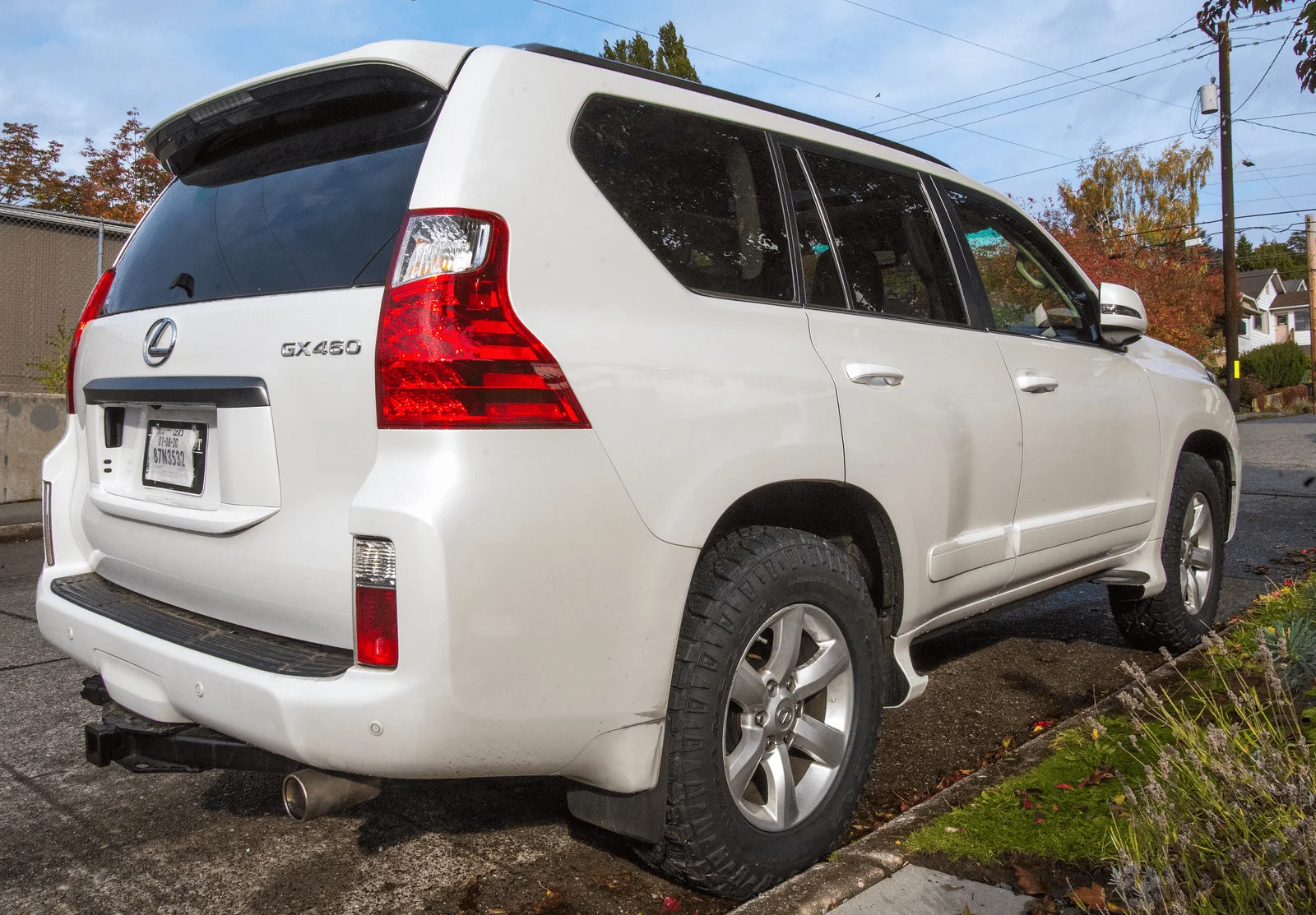

I have Falken Wildpeak A/T3W 255/70 R18 on 2010 GX460, no lift. Had minimal rub, easily fixed in 15 minutes with heat gun. I have been happy with the tires. Only photo of the tires on my phone currently.
Love the custom dirt job! Looks like you're actually out on trails and not at the mall!

I installed 255 70R18 Goodyear Duratracs this weekend on newly acquired 2013 GX. I've had good experience with this tire on snow and it is the right combination of attributes for my driving in the PNW. (Have been driving Toyo AT2 Extremes 295 75R16 on a 100 Series for past couple years).

Here are some pictures of the stock spare tire underneath my vehicle. The stock size is already contacting the tow hitch frame, so I'm not too hopeful that I can fit a 275/70-R17 under there. I may try to adjust the tow hitch to see if there is any way I can slide it backwards a bit. I wonder if I can slide the spare tire forward as well?
