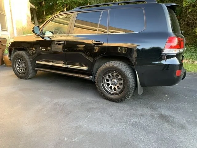

I just put these on my stock '17 in 285/65r18 and so far they are great!
I ran the same tire on an F-150 for years. They have great wet weather and snow traction, not to mention very good mud traction for an AT tire. Plus they wear pretty well and are quiet (for an LT all terrain tire). I've ran KO2s and Duratracs as well, and the AT Adventure is a much better and all around tire than both
I just got those new Goodyears in 285/65/18 and am very happy with them.
I just bought the Good Year AT Adventure tires as well in that size. I haven’t had them long enough to really evaluate them. They do rub on the front mudflaps at 3/4 turn. They are on 18x9” method wheels. My truck is being shipped to me now, and I didnt check the air pressure after they were installed, but they rode very rough on my limited post install drive around the beltway. I chose them because of weight, good reviews/comparison scores and I’ve had great experience with the MT/R with Kevlar on my Jeep.

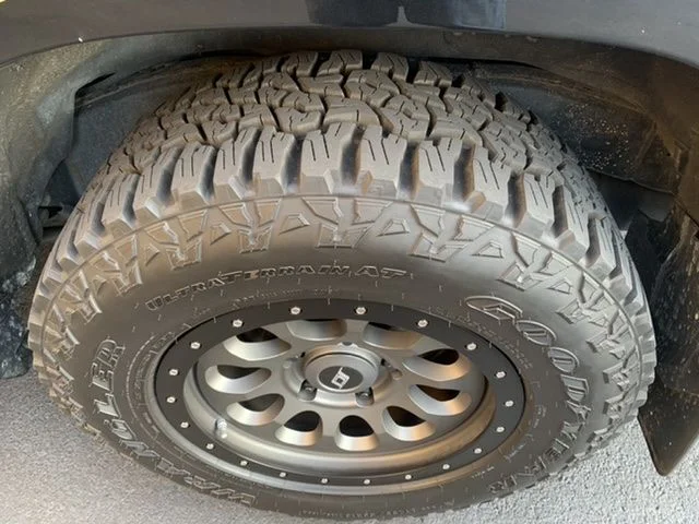

Very interesting. I was just going through the Discount Tire website and found these "Goodyear Ultraterrain ATs" and was going to post a question on the forum about them. I can't figure out if they are newly introduced or a discontinued tire because they are not listed on either Tire Rack or the Goodyear Website. What am I missing? I'm adding them to my short list They look great!
As far as I know they are new and only available at discount tire. I’ve only got about 5k miles on them so far but they are 100% better than the oem tires for sure. I’m running them at the pressure recommended by Gaijn here on the forum.
I’m convinced that 285/65/18 is the best size if you aren’t going to lift your LC. I had to massage the fender liners ever so slightly and take off the front mud flaps. Could have molded those a bit as well but I was just being lazy and thinking about getting front spring spacers.
