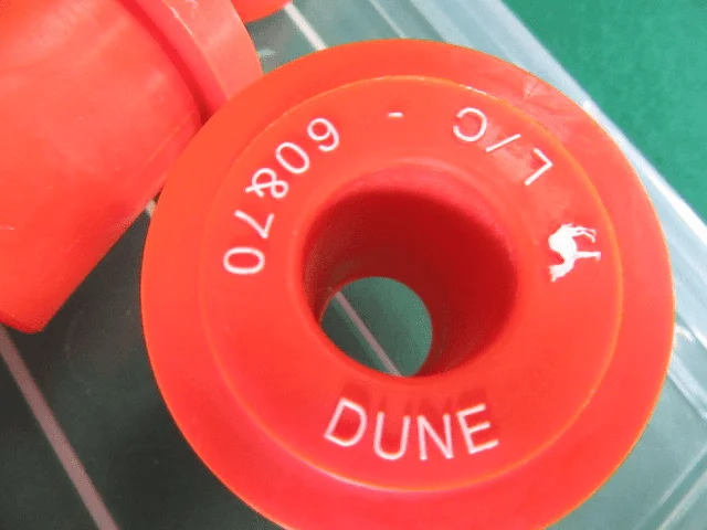

A friend of mine imported a 2003 HZJ77 from Japan. It came with an aftermarket suspension with "Dune" branded shackles and bushes. These are polyurethane bushings as well but are not designed to be lubricated/greased. Which made me doubt about it's durability. 12 years on with no greasing and the bushes are still doing great with no signs of squeaks and heavy deterioration.
This made me buy a set for my BJ42 as well. It costs a lot more than the likes of OME but my friend's set outlasted my OME bushes by 5 years. I know these are different vehicles but the HZJ77's higher GVW was the deciding factor for me.
Photo for reference.

@Rankle40 - those Dune bushings look fairly hard, will definitely look into them next time, but suspect they only come in the later larger spring eye variation (still I'll check later tonight).
