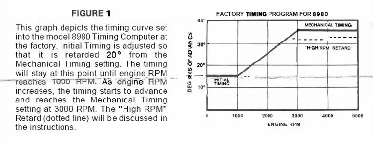

As Cruiserdrew said points WILL wear and there are many options like MSD or pertronics. Who wants to put their tail between there legs and limp home with fouled points. The MSD system isn’t cheap but I have had the system on 6 different cars/trucks over a sum total of 40 years (between the cars), have swapped the MSD from one car to another, none have ever failed, and the timing computer with a 20deg retard at startup makes starting easy (plus no vacuum hose issues or mechanical advance).
