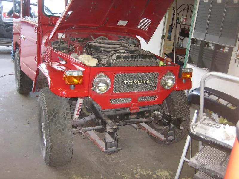

I put Cruiser Corps aftermarket fenders on my '82 last year. They fit perfectly and no banging or hole drilling was necessary. Their fenders come from the same Taiwan supplier as SOR. They're 16 gauge steel and didn't feel any thinner than the trashed original fenders that they replaced. Not sure about CCOT's source, but I looked at their fenders and they appear to be identical to those I got from CC.
