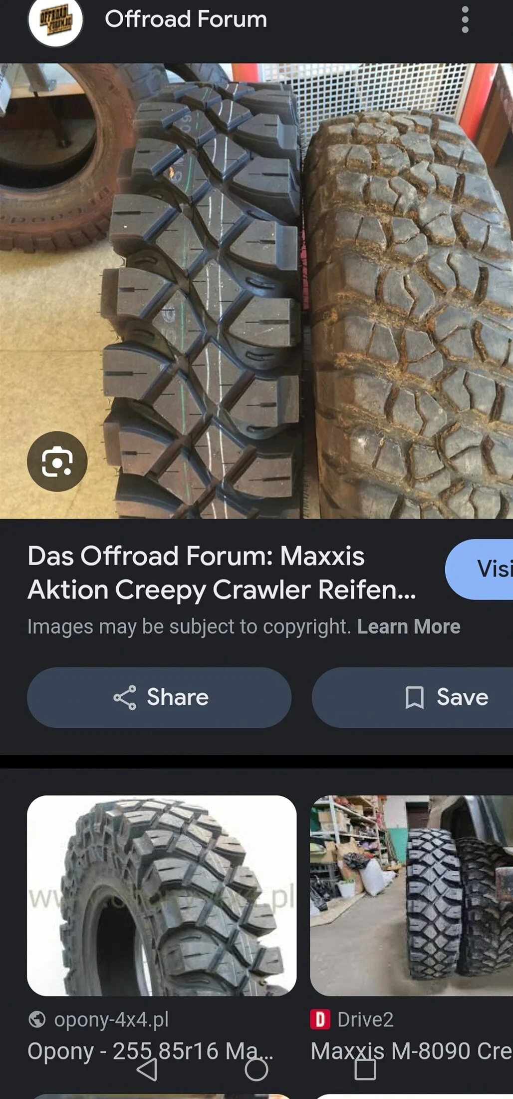

I hadn't previously found that german forum, so I googled it up to find some better pictures. A 22cm wide 255? The competition is now between this and XZL. No measured diameter though, I would like some other source than Maxxis themselves.

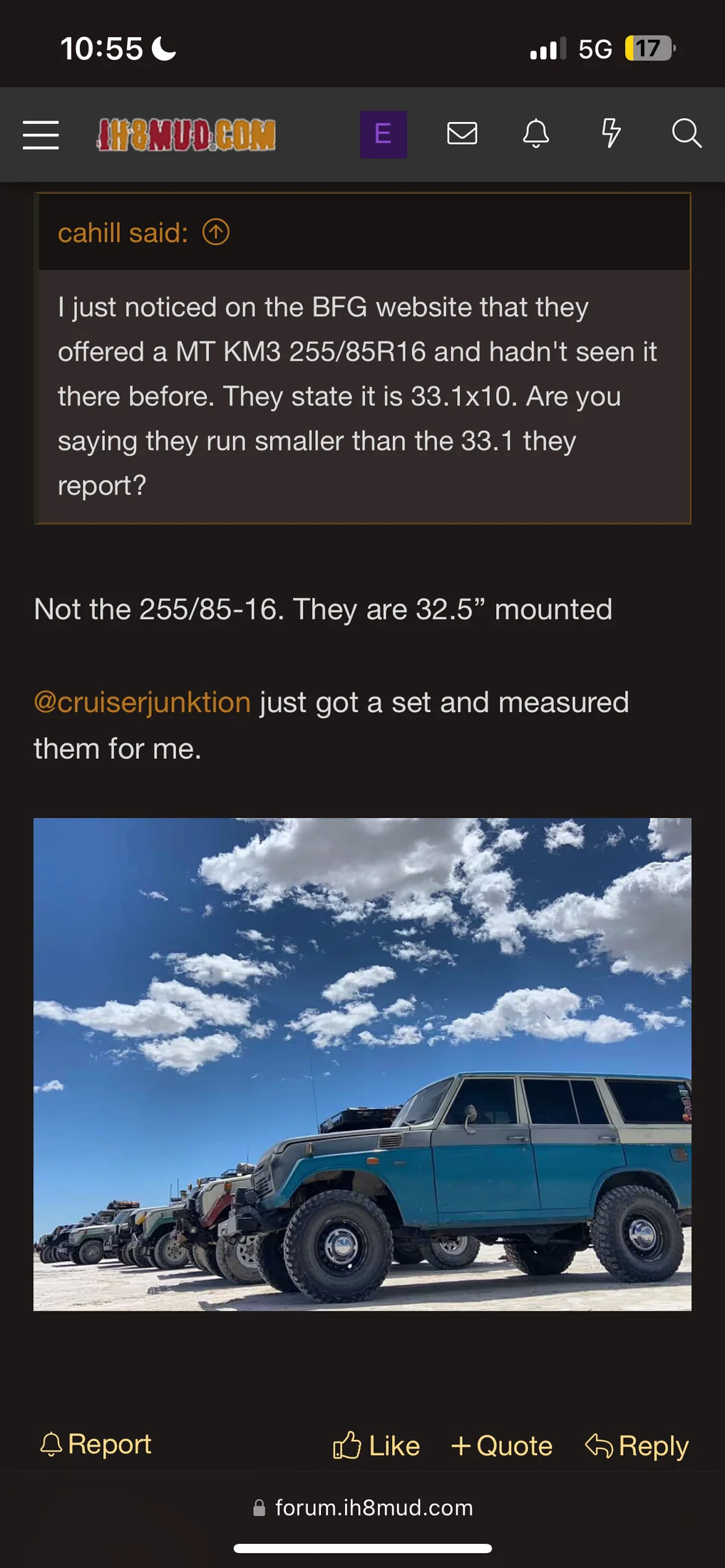

Another option would be the 255/85R16 BFGoodrich KM3 mud terrain, likely a lot more expensive than the others though and possibly run small compared with similar tires in this size.
Almost 100€/tyre more expensive than the other options. Would probably be the best compromise between off road traction and on road tread life, but as you mentioned they're probably not very tall and skinny. I'll try to look up measured dimensions though.
