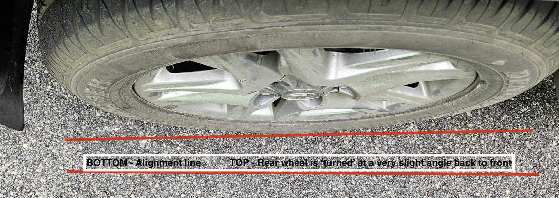

To my surprise, there was no visible exterior damage. I proceeded to inspect the mechanical components, and at first glance, everything seemed to be in order - AHC, 4-Lo, etc. were functioning properly. However, after driving a bit further, the VSC illuminated, displaying a 'steering angle zero point malfunction' error. This made sense, as I realised I had to hold the steering wheel at a 30-degree angle to maintain a straight trajectory. Upon pulling over and re-examining the rear wheel, I noticed it was significantly tilted 'back-to-front', reminiscent of an Acura with rear-wheel steering.

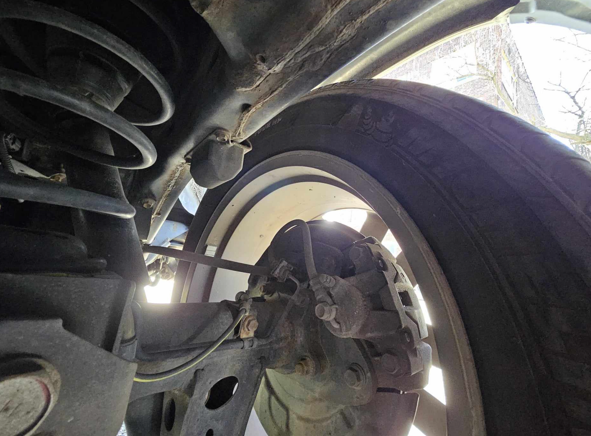

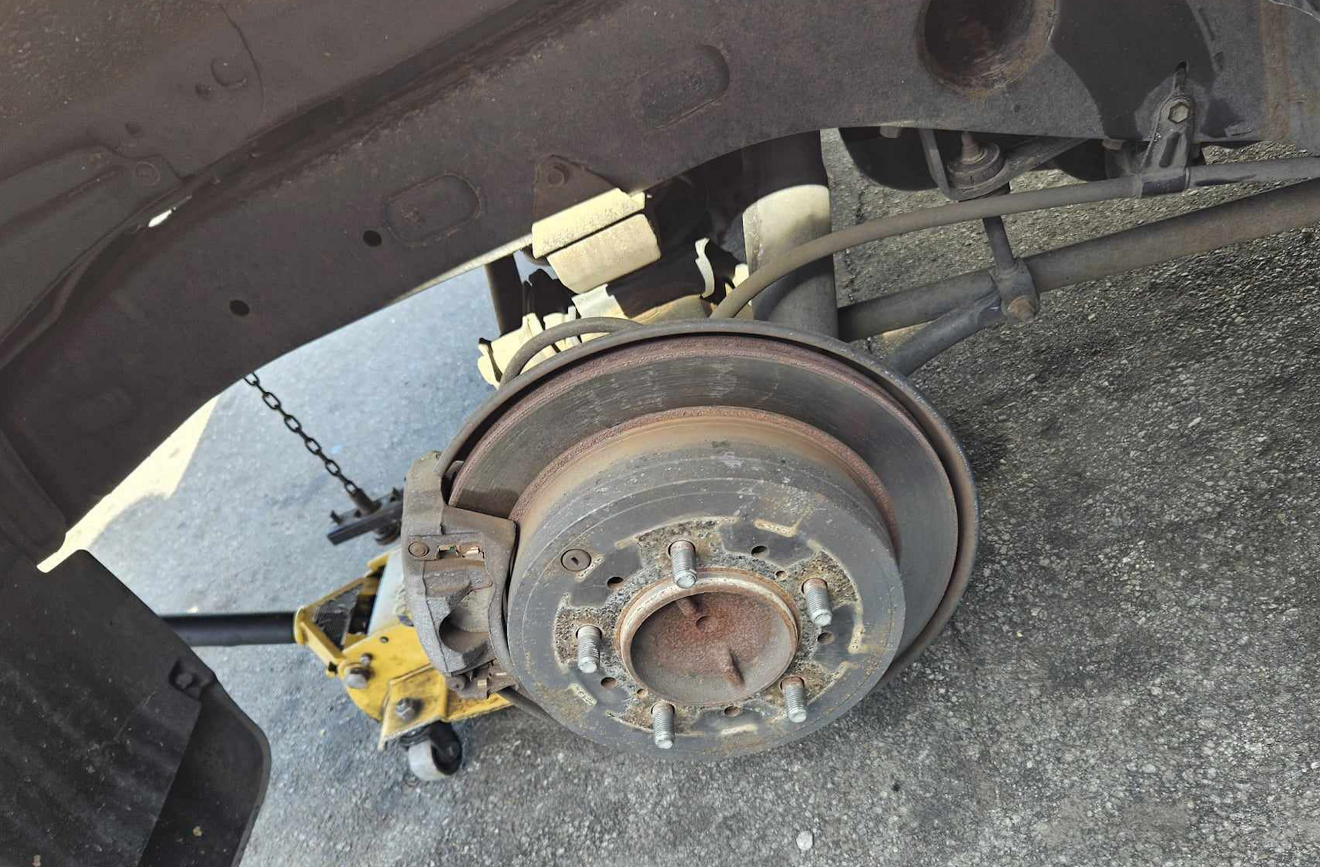

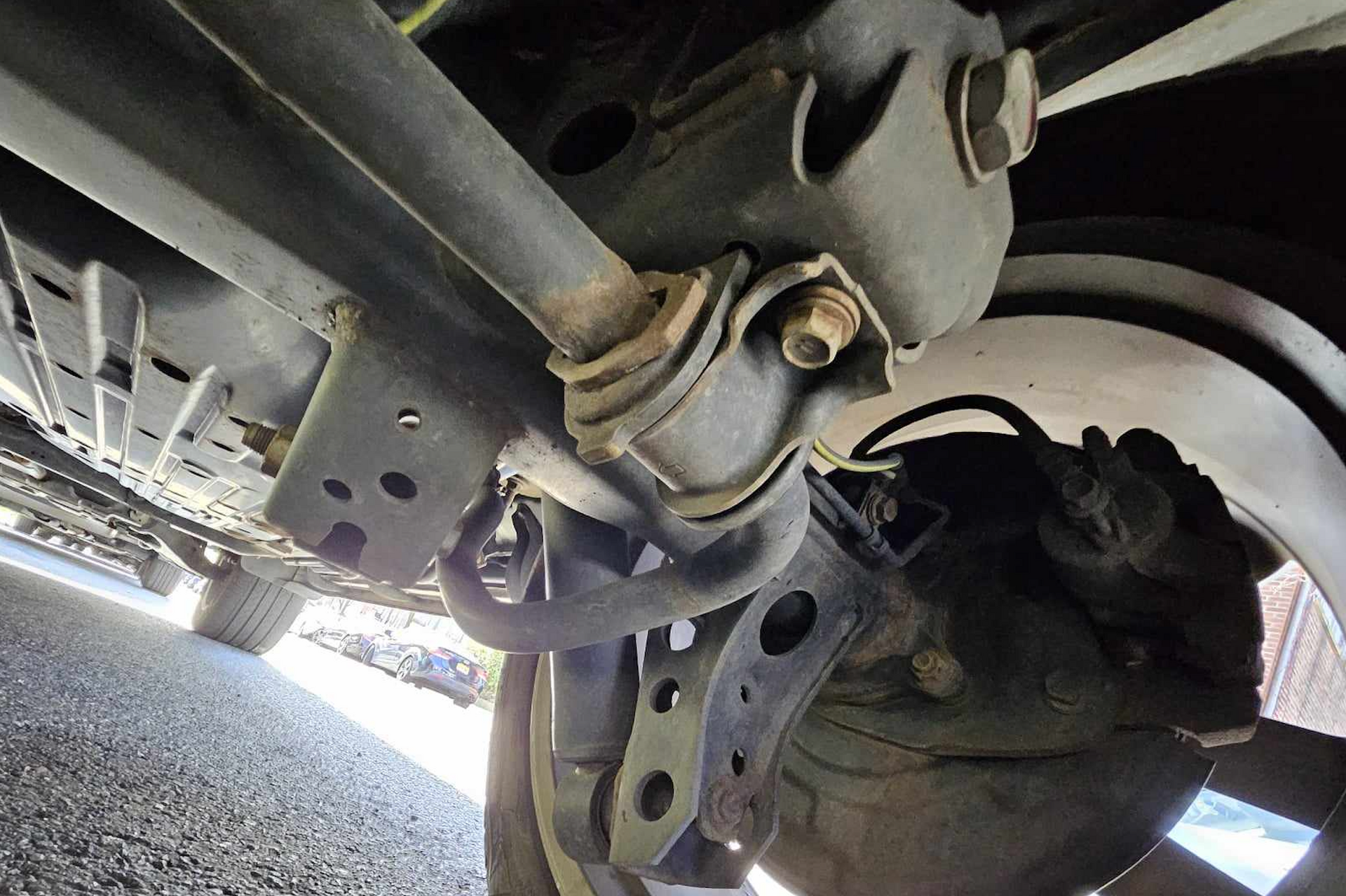

As I don't have comprehensive insurance, I'll need to repair this myself. My initial thought is that the rear axle or hubs might be bent. I've attached a couple photographs of the relevant components for reference (you can find a video as well here: )

Thanks a lot for the information, guys, it's super helpful. Sorry, it seems the pictures didn't get posted - I have attached them again with this message in case it's helpful for narrowing down the problem.
I agree with @bloc you need a professional assessment of the damage. Even if you do the R&R work yourself, I’d venture to say there is no reasonable possibility of determining extent yourself. You may end up doing something that doesn’t need to be done or missing something important. I’d start with an alignment shop to see what, if anything, is out of whack. I don’t see any damage to the wheel/tire that would indicate a hard enough hit to bend an axle or housing. Are you sure the hit was at the rear?

See below for the yellow portion, follow that to the speed sensors and check them and the plug connecting them.
As for alignment, i am not quite willing to bet tacos, but i will take an educated guess one of the control arm frame brackets are bent, not the housing itself. Stick head under and snap some pics of the brackets and see if any paint has peeled from them bending.

Thanks a lot for your help, guys, it's extremely helpful for me in terms of figuring out the next steps and tackling this in an informed manner. Regarding the tire & wheel, I have put on the spare in the pics - the original tire burst and the wheel got a little scratched up. The car is smooth to drive at 50 MPG (other than having to hold the steering at an angle), so my initial thought was that it's unlikely the axle got bent.

I would like to know which way you’re holding the wheel. That’s the passenger rear that’s bent. If you’re having to hold the wheel to the passenger side(steer into it), I’m going to say the axle is 100% bent.
Take a straight edge with you when you go back, you might be able to find a spot you can hold it against. It would be bent not too far behind the backing plate I would think.
