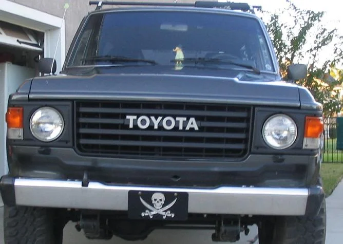

I have a 1985 FJ 60 with a chrome grill. I want to have it spray painted black, possibly with Bedliner spray. Has anyone done this and what were the results? Thank you for any feedback.

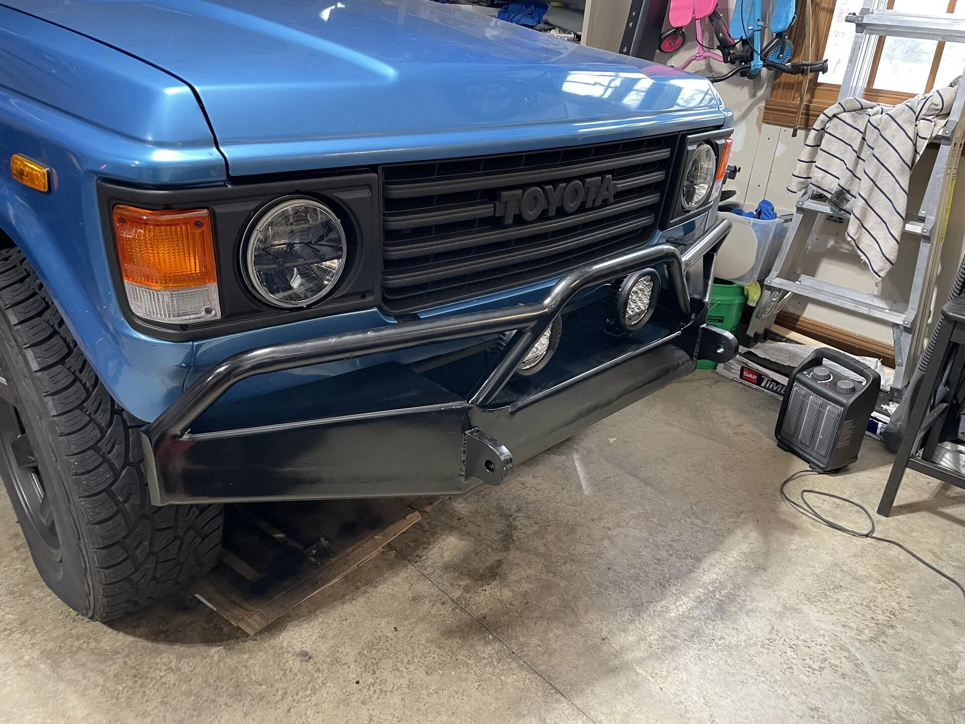

I haven’t done any chrome, however I have done many aftermarket bumpers, they turn out well. The key is to use a Schutz gun to get a consistent spray, and once done, use a rattle can with high-gloss black paint, it won’t look painted, but the Bed liner will have some really good definition to it.

We need a picture of this chrome grill before you go spraying it!
