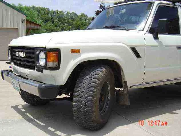

62' black grill
did it too.
warm weekend, nothing else going on.
Nother one....

Here is my grill i finally got around to. used the Bulldog adhesive promoter and SEM "Trim Black". Grill, headlight bezels, front vents and back vents.
Next step is an ARB front bumper!
