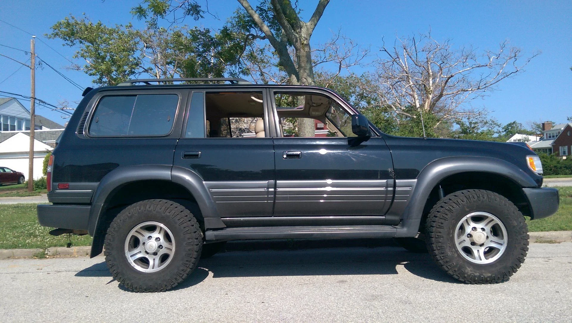

Post some pics! How even is it front to rear?
Here you go. 285 Duratracs, 3rd row seats still in.
I think it's ever so slightly higher in the rear but it doesn't bother me. It's much less than my FJC was when it was stock which I hated.
That said, you will probably need a spacer if you have a big front bumper with no rear aftermarket bumper or if you aren't loading up the back much.
