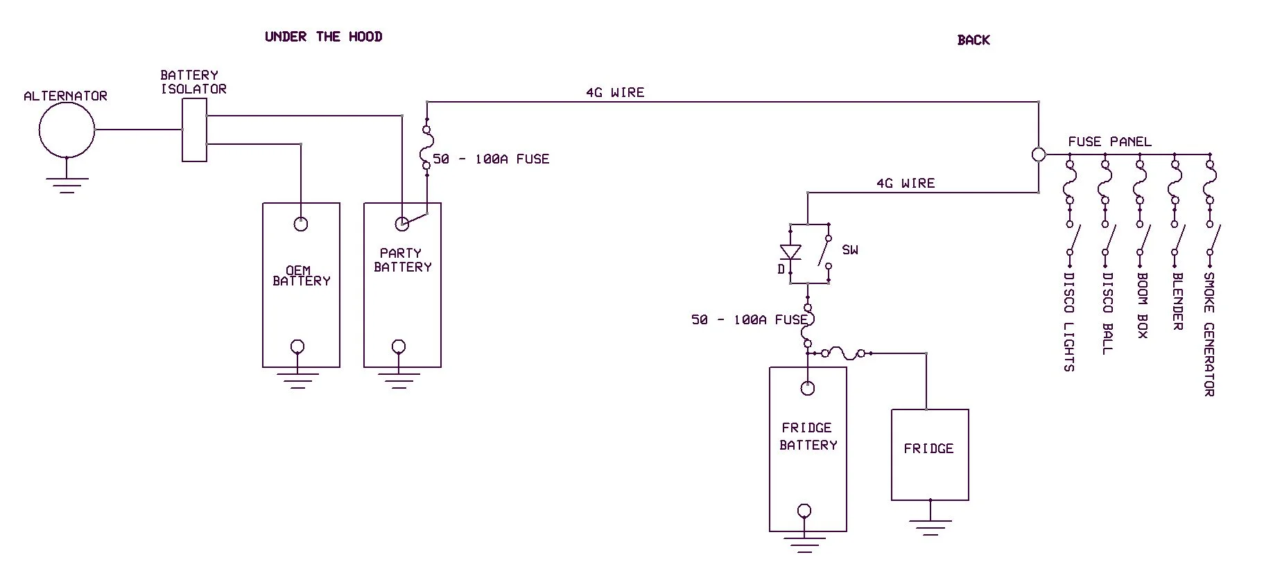

First cut at a schematic.
Rule #1: The fuses are to protect the wire, not the device at the end. The 4 gauge wire needs a fuse at both ends since it can be powered by the party batt and the fridge batt with the switch closed.
Option #1: Diode, no switch. The diode "D" is a "check valve" that lets current flow in one direction. With the diode in the circuit, current will only flow in to the fridge batt and fridge when the engine is running. The fridge is the only load on the fridge batt.
Option #2: Switch, no diode. With the switch "SW" open the fridge batt and fridge are isolated. With the switch closed, the fridge batt is connected to the party batt and the party fuse panel. Fridge batt and party batt are now supplying current to party fuse panel. Switch will need to be closed when engine is running to charge fridge batt and open when engine is off to prevent the fridge batt from "back feeding" into the party fuse panel and discharging the fridge batt. If the party battery discharges, the switch can be closed to provide current to the party fuse panel but the party battery will also put a load on the fridge batt.
Option #3: Both diode and switch. With switch open, option #1 works. Fridge batt is charged via diode. With switch closed, Option #2 works. Fidge batt is connected to party fuse panel and party batt.
