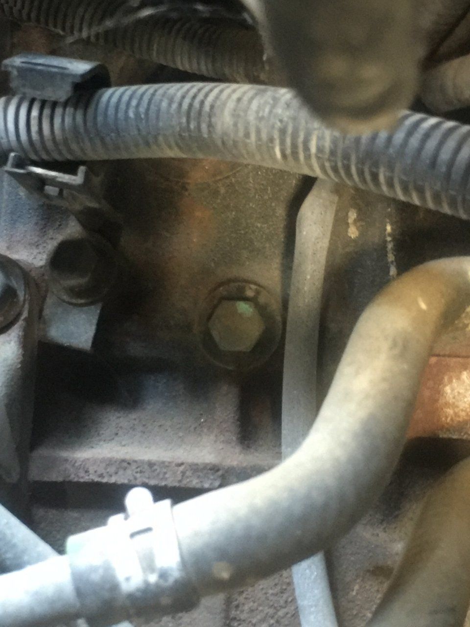

for others draining and flushing. Shots of the block drain. 14mm. Straight shot once tire and skirts are removed from drivers side wheel well.
