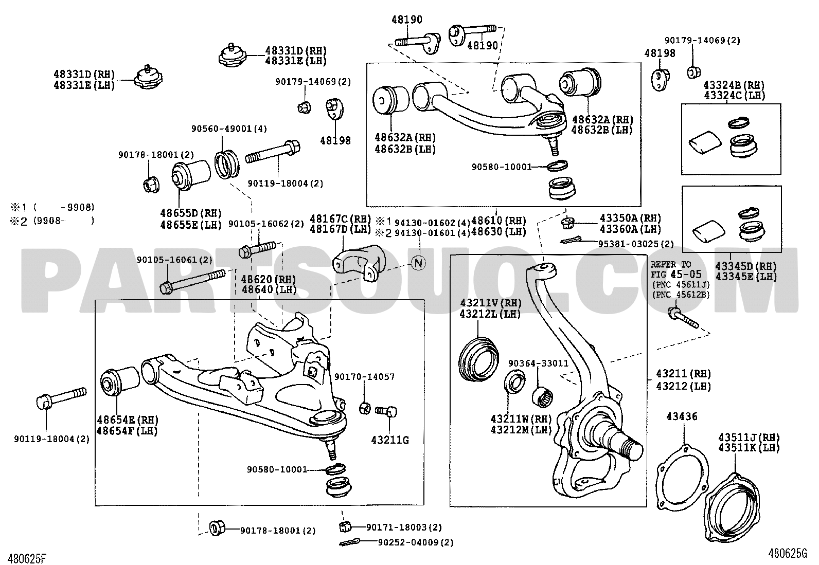

You could also buy a complete arm from Partsouq if they ship to you. Here is the link to Partsouq for a upper control arm for my 1999 100 series. It is only $261 plus probably $50-100 in shipping. Just toss your vin into their home page to confirm it is the same part for your truck.
Thanks For your reply. I have ordered off of Partsoug before and that is fine. The problem comes from this end, The importation tax is staggering, probably 50% on top of shipping etc. I will buy a Ball joint and try to do it my self. Living in the Jungle is fun and all, but it does present some challenges
