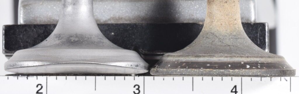

If the valve lash on #6 isn't too tight, the exhaust valve is likely burned (warped). Common.
Usually that's caused by not keeping the valve adjusted. It gets too tight, overheats, then warps, then leaks.
But even a valve train that's properly adjusted can get burned valves (usually from desmogged engines).
After you check/adjust #6, you can do a leak down test to determine if it's the valve (likely) or the rings (unlikely). Search leak down test. It's easy.
