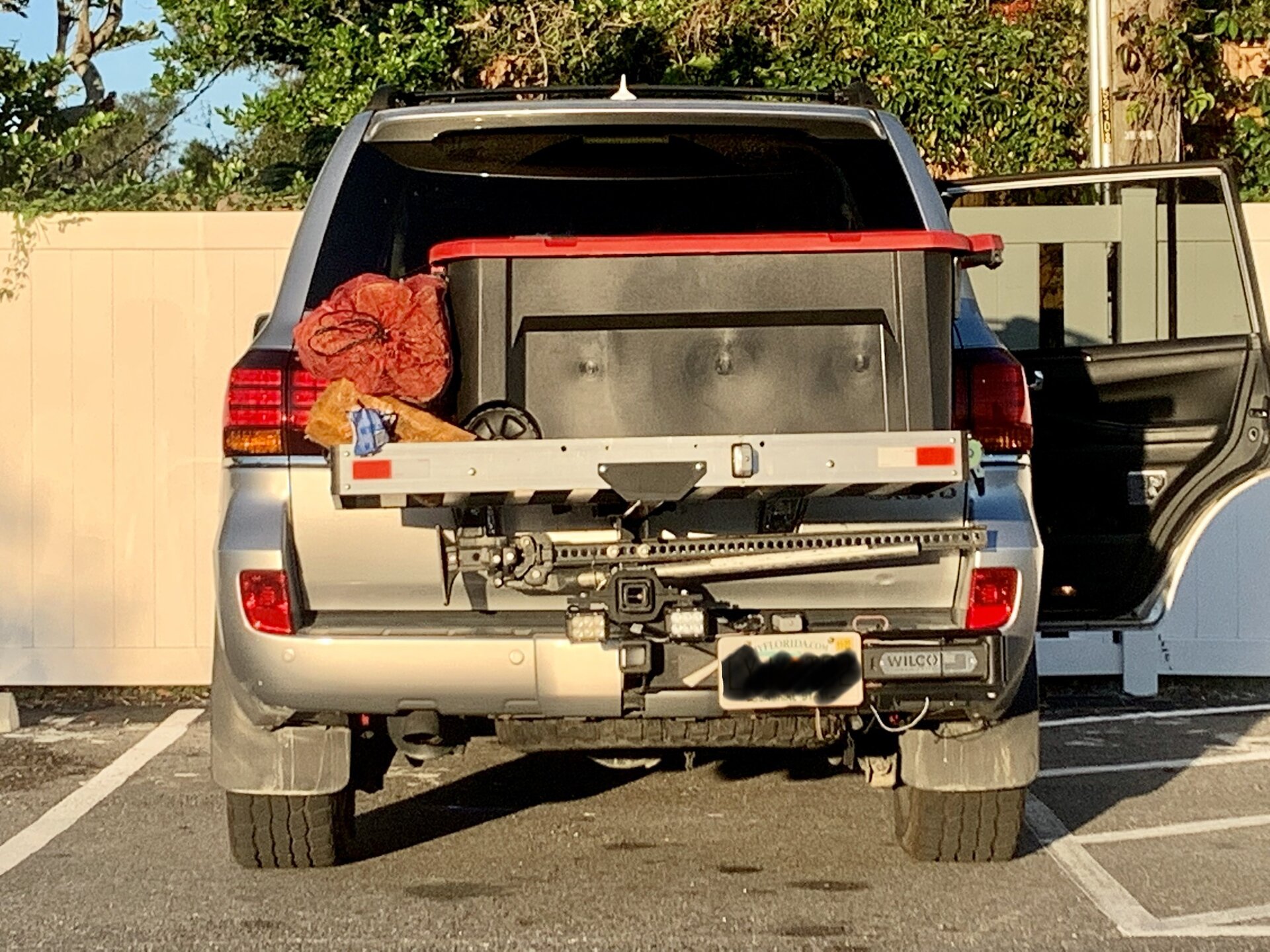

I attached some pod lights to this bracket and ran them off the reverse light wires for the trailer plug…so they automatically turn on when I go into reverse
Nilight 90046B Tow Hitch Bracket... Amazon product ASIN B082W6XBYM
I have a rear bumper with an antenna mount built into it. I’ve run a reverse wire and ground out to the mount, and will be putting a 3x3 Pod light on it soon.
I used a trailer wire breakout box which I installed inline (series) with the trailer plug wiring.
@highfructose idea seems way easier and just as good result, probably better.

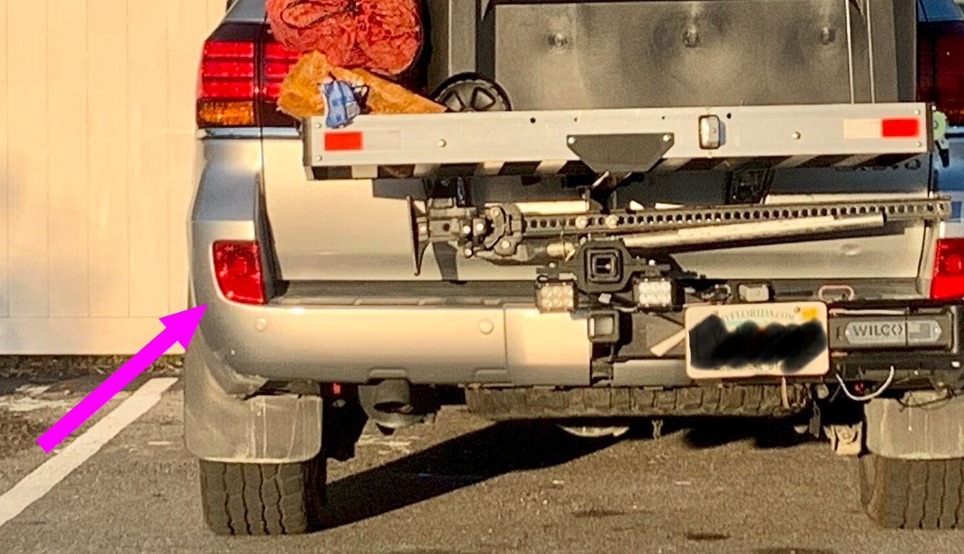

Any reason you are not using the other factory light option rather than adding pods? View attachment 3189899
Those are reflectors. Would be nice if someone offered a reasonably priced insert that one could mount pods in there.

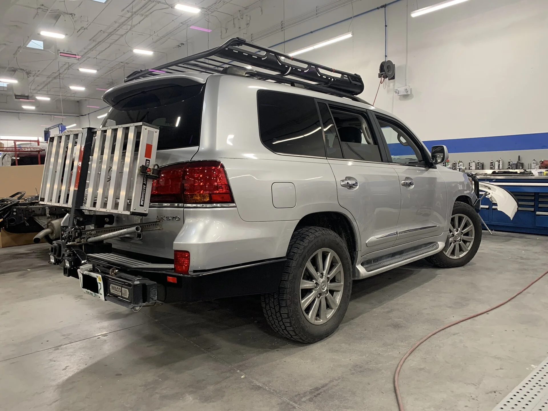

I’ve added an arb bumper that partially occludes the reflector at this point anyway though. The pod light bracket is cheap and easy and made sense given I was already running wires across the Wilco for the license plate I mounted.

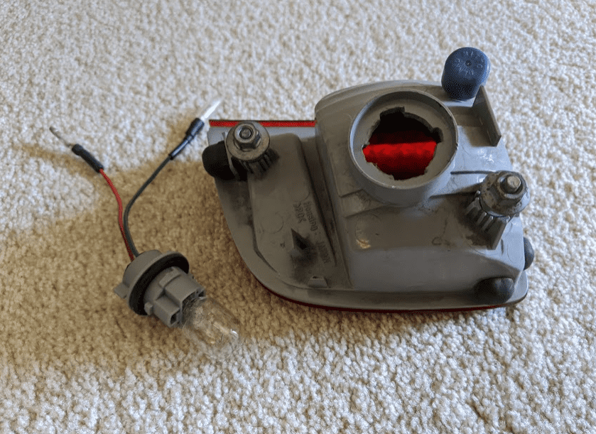

Good point and these are fairly easily modded to add a bulb. Either wired for backup, rear fogs, or whatever one would like them setup for.
There was a great thread someone else posted that I can't find for the moment. Here's what mine look like setup to be rear fogs / chase lights.
Was considering scene lights to the rear. Decided to double duty the as delivered passive rear stock fog light elements for rear fogs and rear scene.
Rear fogs as I often traverse the tule fog through the central CA valley where the fog gets thick.
Yes it's red, but that's not a bad thing for nighttime. Separately, was thinking to also double duty the large rear backup lights on the LX for added scene lighting, but I'm getting enough light with just these fog elements.
Adding a socket and bulb to the fully fleshed out except for cut receptacle stock light fixture. 7/8" hole saw. Then dremel for the detail detents.
