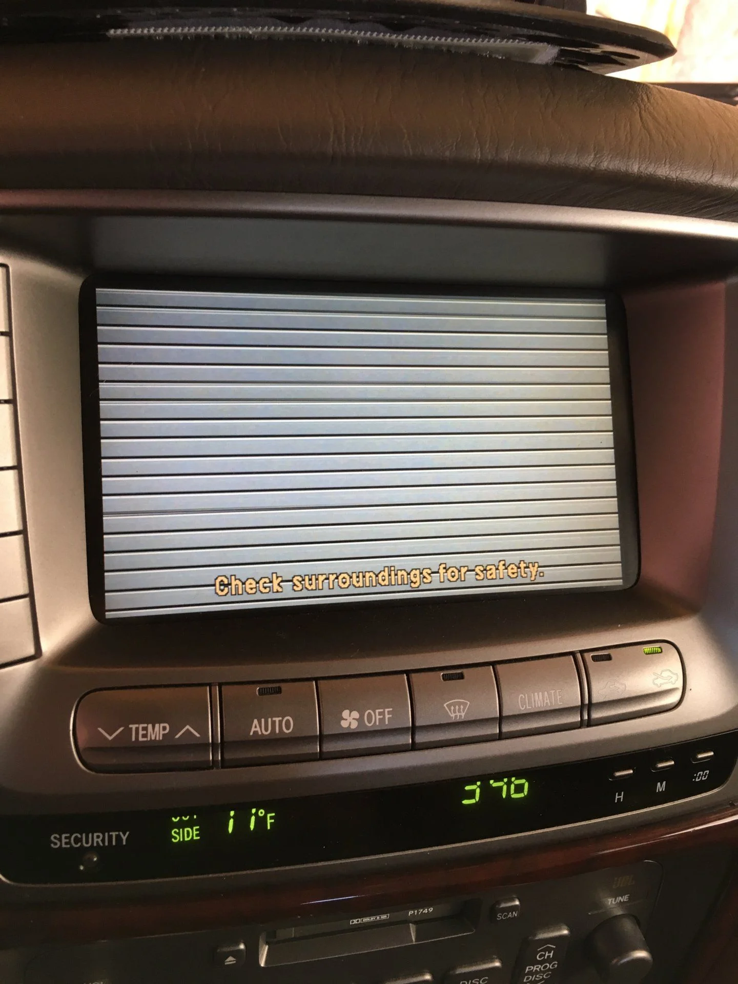

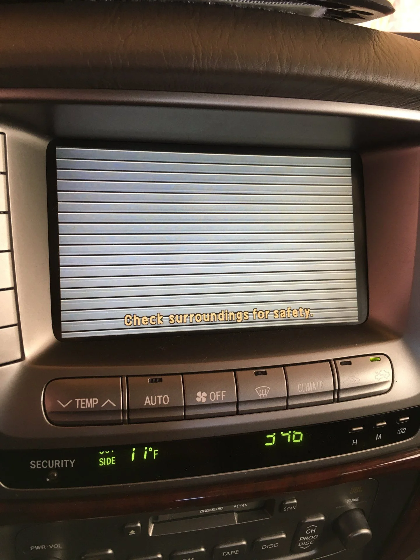

How to fix backup camera? Navigation and screen works fine just the backup camera is not. What could be the problem? Anyone has this issues on a '04LC? How did you fix this? I want to keep it stock so no after market options for me.

When I bought my 04 the touch screen worked fine for everything but the camera. In my case the display was black rather than white with black bars, but the "Check surroundings for safety" banner showed up as it does in yours. That suggested to me that the issue is not the control unit, since *something* was sending that signal to the screen. Apart from a broken wire, which seemed unlikely, that left the camera itself. Took it to a very good local car audio guy who confirmed my diagnosis and replaced the camera with an aftermarket unit for $120 including labor. Since the camera is barely noticeable I didn't care about staying stock. If you're dead set on stock, you can get an OEM camera (P/N 86790-60020) from McGeorge for $503.51. (List is $764.85.) And if in your case it also proves not to be the controller, be glad: McGeorge will sell you one of those for a mere $1,430.28.)
