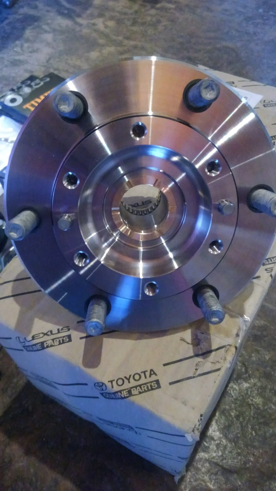

Long story, but got tired of dealing with the flashing light on the dash.
Pretty easy because of Toyota engineering; Bought a manual J-shift transfer case form a 2000 4runner and the drivelines off the same donor vehicle to make them fit.
Phase one complete.

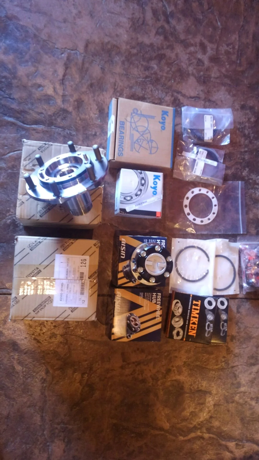

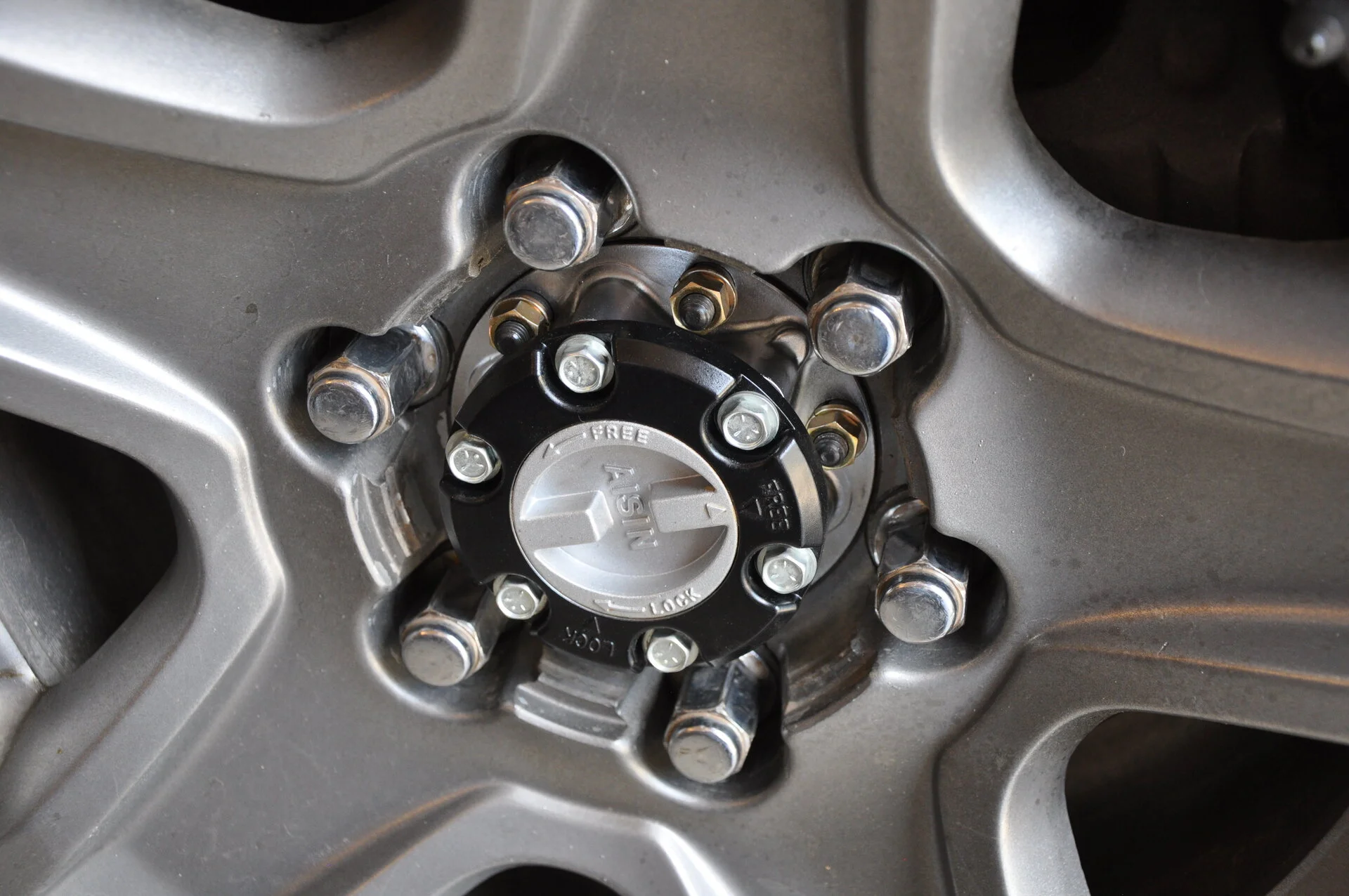

Then bought a complete kit from Yotamasters to covert the front diff to locking hubs.
Even comes with new axles.
I took the cover off the front ADD and locked it up and everything is golden now, super happy with the results.
