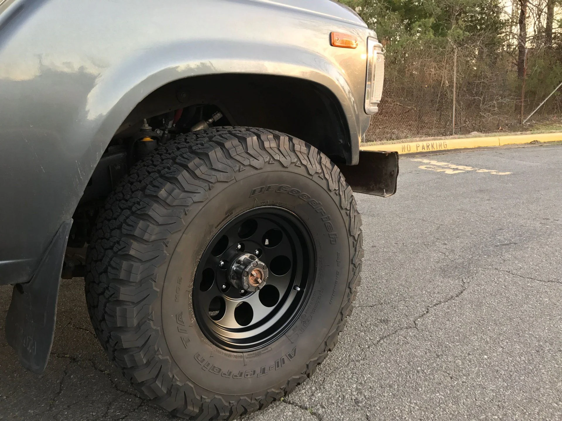

@TRFCSUX, got the Level 8s on today. The 15's fit perfect; ample clearance of both the caliper and the tie rod end.

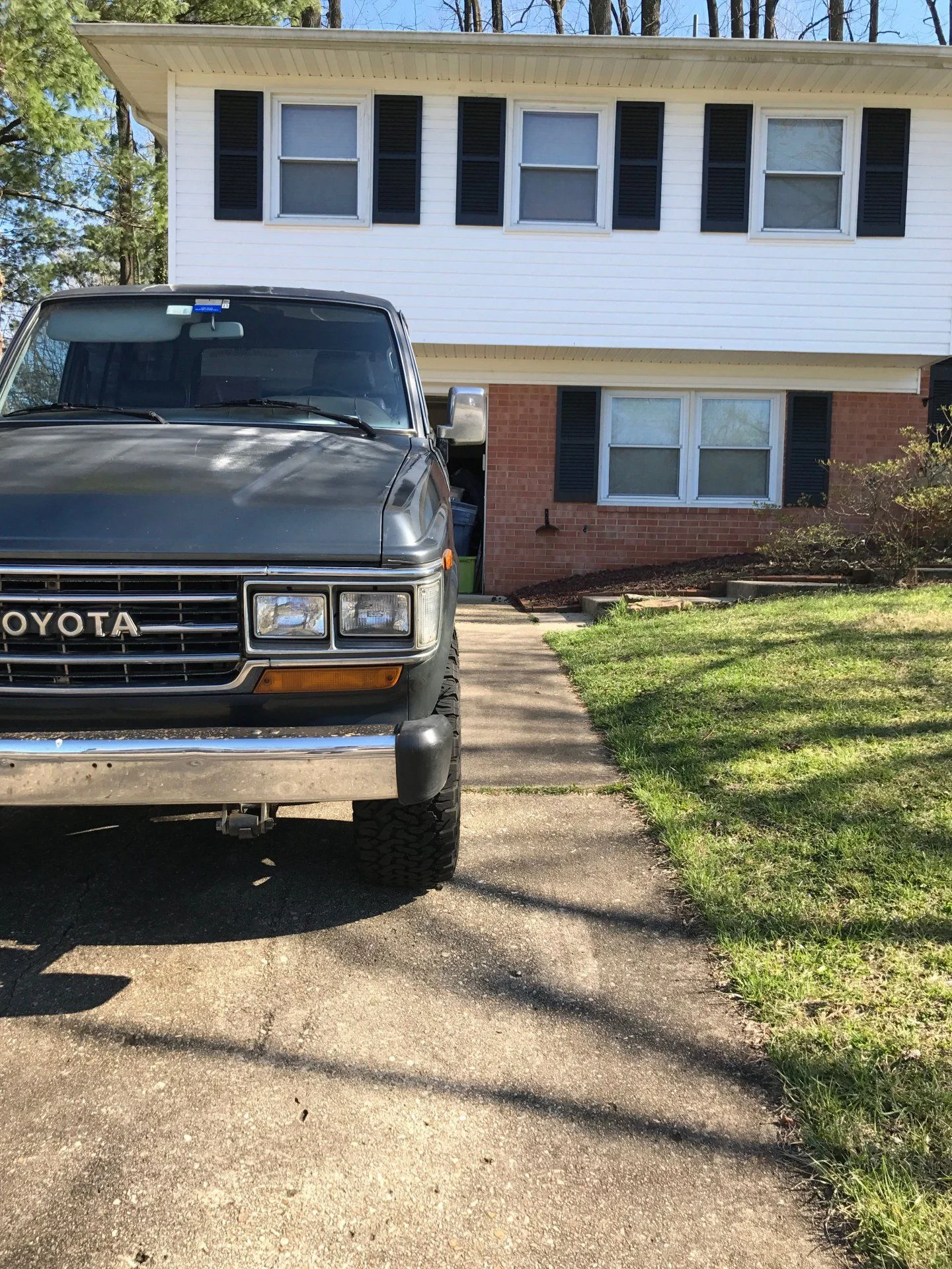

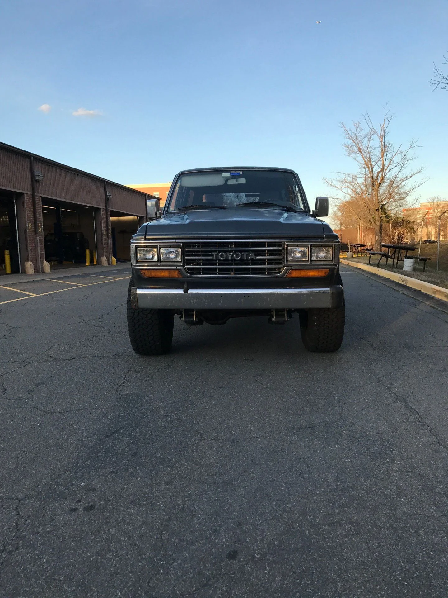

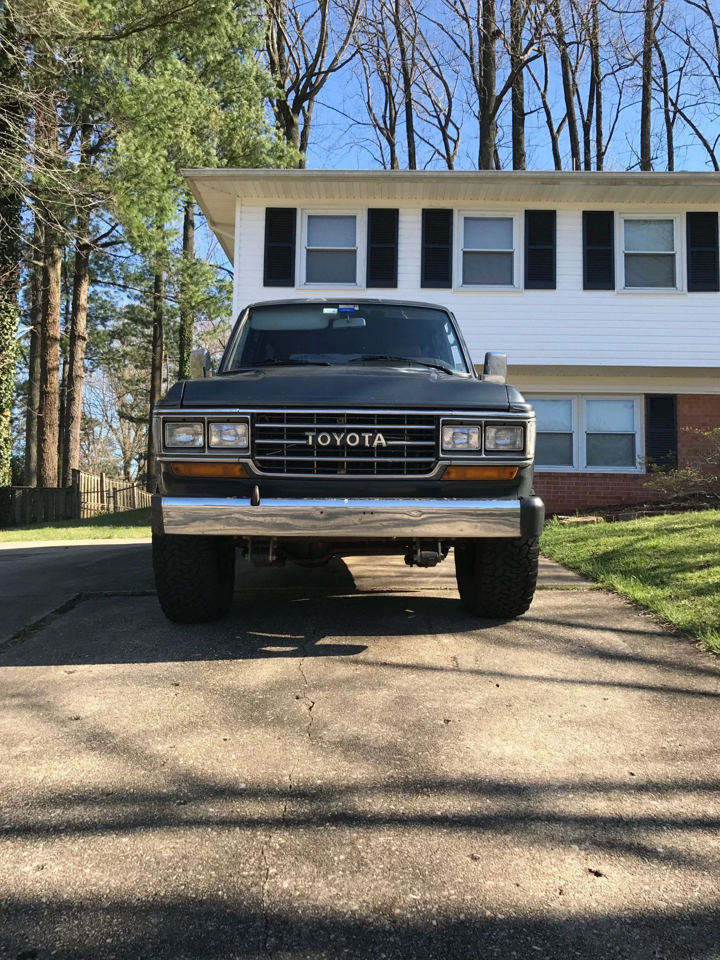

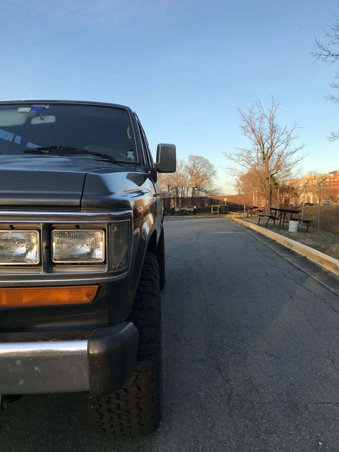

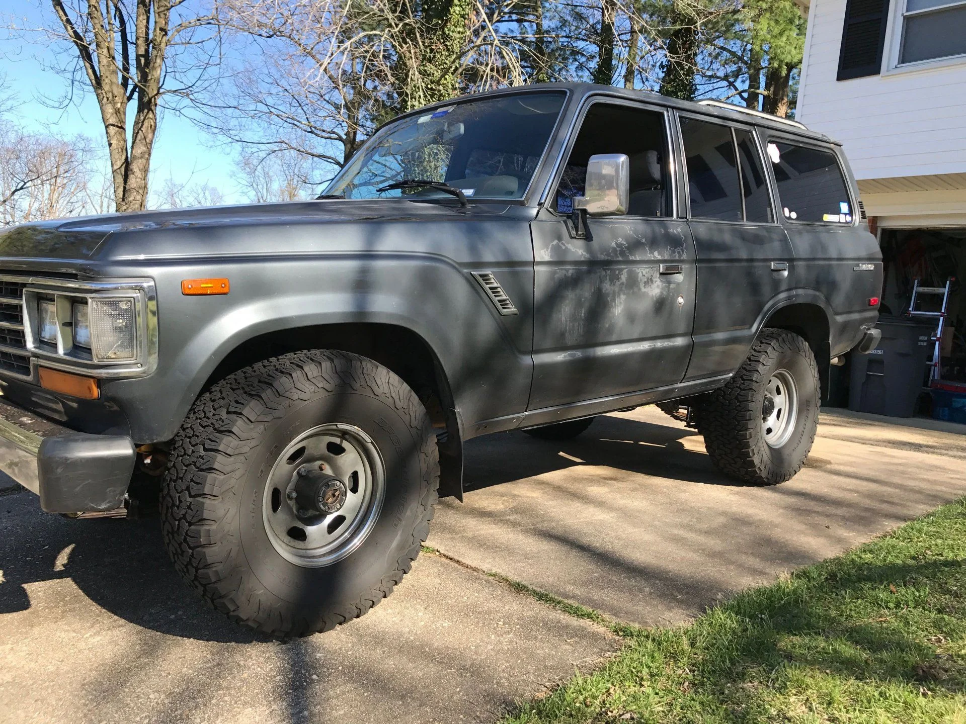

Pics below; I'm running BFG A/T KO2s - 33x12.5x15 - getting them off the stock 6.5 inch rim onto the 8 inch rims improved the looks, ride, and safety.
Before:
After pics in next post...
I think they look great, paint looks fine also. So they are the ones they list with the 3.32 back spacing and the -30 offset ??
Thanks for the help and the pics
Thanks! I'm not sure on the 3.32 backspacing, but it is the -30 offset. Here's the link to the same wheel on Discount Tire:
Custom wheels for your 1988 TOYOTA LANDCRUISER made by Level 8
This is exactly what I got and like I said they fit perfect. With free shipping and the $50 rebate they're running right now, I got four wheels delivered with new lugs and valve stems for $403.
It did push the tires out just a bit from where they were, which is partly due to going from the 6.5" rim to an 8" rim. Plus, I'm running 12.5s. I think the ideal setup with these wheels, if you want to keep them tucked JUST inside the fenders, is to run 10.5s on them. Can't go wrong...
