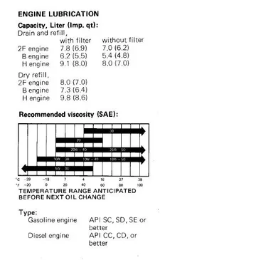

Waitin on my manual for the bj 40, but wanted to get started. what is the capacity for oil in the b engine? thanks, ...
This is what the owners manual that came with a 1979 BJ40 says:
