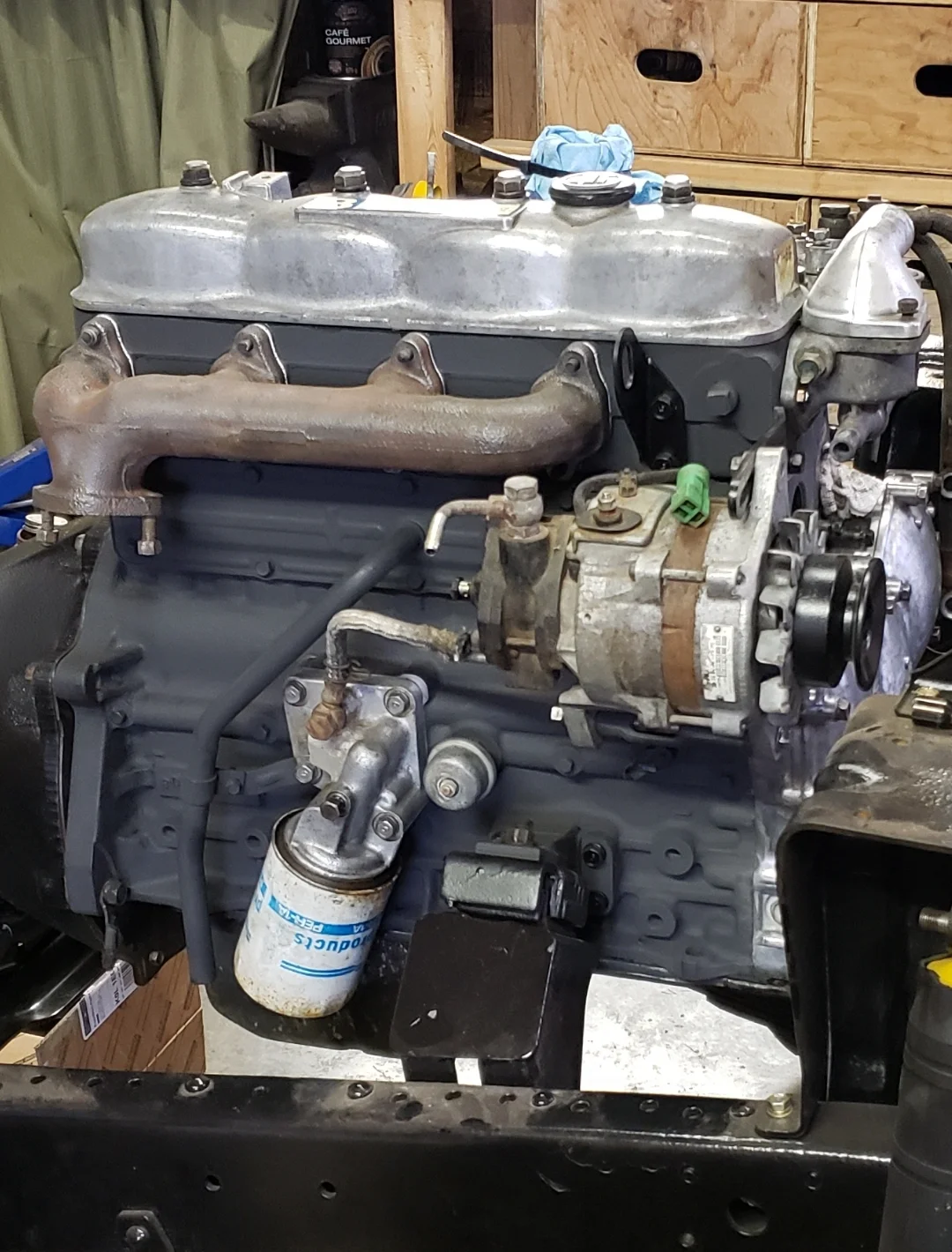

I tried to start my B engine the other day, and it didn't have any oil pressure.
How do you prime a B engines oil? The oil gally side is considerably different from a 3b.
Where can I open up and put oil?
Here's what I got

Nice looking rebuild, nice to see no silver paint on the aluminium parts. What year is the engine?
