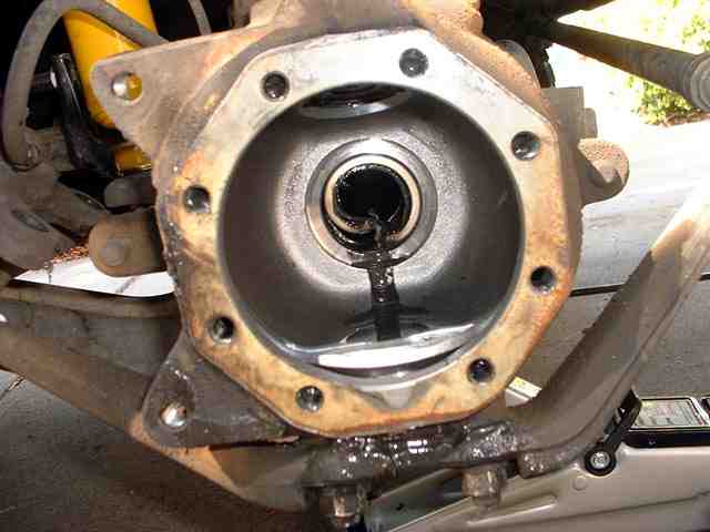

Supposed to take out the oil seal like this: (not my pic, and yes the axle shaft is out)
Is there another tool I'm supposed to be using...cause that thing won't fit in there at all.

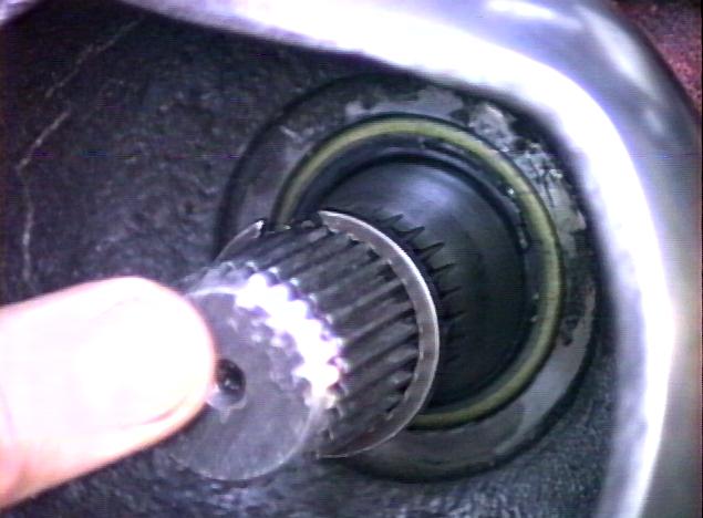

Given you are replacing the oil seal - doesn't matter if you destroy it. Easiest is FIRST put finger in and pull out the spring on the inside of the oil seal so it doesn't drop into the guts of the axle tube and SECOND use a screwdriver with a hammer to crush/destroy the oil seal. Once a little crushed it will just pull straight out.
You can see the 'destroyed' oil seal ->

It will fit in there. Just hook one side of the tool behind the seal and then pry it up and out. Takes no time at all using the seal puller you posted.
I either over or under thought this....
I was going at it with the knuckle in a straight position....like if the tires were pointed forward.
I turned the steering wheel full locked left and was able to get one of the hooks in there and pop it out.
