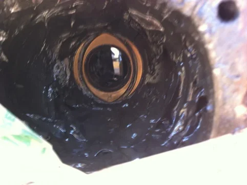

On my 1967 FJ I saw these grooves on the axle tube. Are these worn or are they correct?
If you mean the grooves in the brass busing, those are normal grease channels.
