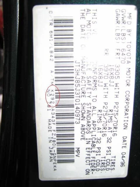

A white door sticker such as attached below would indicate that it was not a JDM model as the JDM's have the Axle/Transmission/Trim information on a stamped firewall plate:
attachment.php
