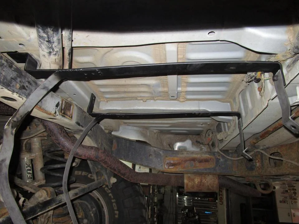

Brackets installed to hang fuel tank using blazer tank mount straps.

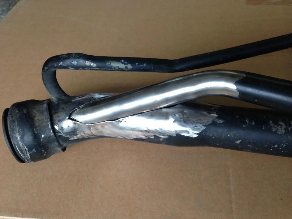

The most difficult part of this build was creating the filler neck. Although I could have used the Toyota filler neck, I wanted a simple system without any knobs or levers. With my siamese filler neck, the main tank fills normally. No pre-flight instructions required for any crew members borrowing and filling the truck. Just don't put diesel in there. To fill the auxiliary tank, the nozzle is pointed back towards the aux fill neck, and I can feel when it engages the tube. I can therefore fill either tank, and the 'hidden' auxiliary tank fill isn't an issue for anyone else.
However, some fuel station nozzles have a stopper ring below the spring, and won't allow easy filling of the auxiliary tank. Also, I haven't been to California yet, so don't know if a vapour recovery nozzle will reach the aux tank filler either. The main tank filler is unchanged so there's no issues ever filling the main tank.

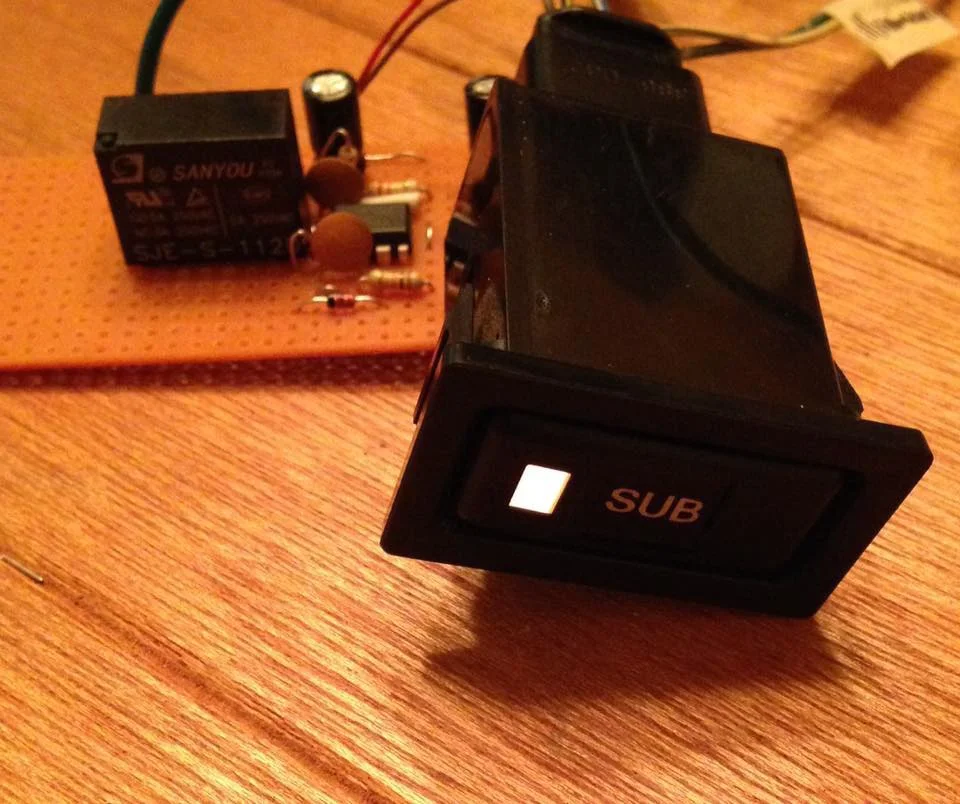

Fuel pump controller on the breadboard.
There's a timer to start the pump and run it for 30s to initialize fuel transfer. There's an input from the main fuel tank level gauge to halt fuel transfer when main tank is 9/10 full. There's an input from a flow switch to interrupt transfer when the transfer pump stops pumping fuel (and tries to push air).
Assembled on a prototype board. Powered using a defog switch that's been re-labelled SUB. Thanks Joey Romero for the switch labels.

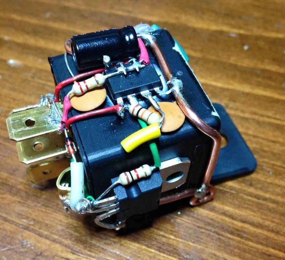

The final circuit, deadbug style built on a BOSCH automotive 12v relay. It's tucked in the center console behind the SUB switch.
After I built the discrete fuel pump controller, my brother (a computer geek) asks me why I didn't install a programmable microcontroller. He explained to me how much more robust the microcontrollers are than discrete componentry, and allow easy it is to make firmware changes. Plus multiple inputs and and outputs for monitoring. Microcontrollers are used everywhere and rarely fail. The keypad on a microwave oven, for example, has a microcontroller driving it. When's the last time a microwave oven died because of keypad/microcontroller failure?
I figure discrete componentry is plenty robust. My controller has a single monitor output, to illuminate the SUB switch lamp when the pump is running. That's all. Two inputs, one from the fuel level sender, and one from the pump flow switch. I eliminated the potentiometer in the prototype and replaced it with separate resistors which are both cheaper, and non-adjustable, so it cannot be knocked out of adjustment. 555 timer chips don't die, and voltage comparitors are pretty stable too. It's been a long time since high school electronics, but I can still sorta solder ok. And deadbug circuits are so steampunk. lol.

Filler neck took two tries. I had purchased a spare upper neck from a 'mud member that put a dual neck in theirs, so I modified it. Then ripped it out, and modified the original filler that came out of mine. So a whole whack of time to do the filler neck. Didn't work properly until the second try. Would've been cheaper to buy a used toyota dual neck and put it in. But what's the fun in that? Only other thing I would do differently with the filler neck is to add a second air return fitting and do separate air returns so that I can fill faster. Because the gas station nozzle shuts off when it touches fluid, and the air return pipe, if it has fuel in it from the other tank, will slow down filling.

edit: looking at the pics, it appears that the tank is designed with different brackets. My upper brackets are made of 1/8" thick steel, and we just looped the straps underneath like any other Toyota. So we are probably using the same unit. Only mine is slapped in differently.

I like your build, the only item I would add would be some strips of rubber between the tank, and it's mounting brackets. I've always been a safety nut, so I'm not a big fan of metal, rubbing against metal, on a fuel tank. YMMV

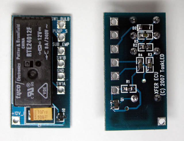

In case others come to this thread and don't have the ability/fortitude to make their own transfer ECUs, we have a Mud member who makes a very nice fuel transfer ECU on a tiny PCB. It lights up the Sub tank light while running the aux pump and then shuts off the aux pump when the empty signal gets activated from the aux fuel tank empty indicator. I've been using it for 14 years now. Anyway, just a FYI.
Yes! I read about George's auxiliary fuel tank ecu, and that's what inspired me to make my own. And I am in debt to every single writeup of auxiliary fuel tanks on this forum. Without the forum, and all the pictures and writeups for inspiration, not much would have ever gotten done on my truck.
Is this a photo of what your talking about?
