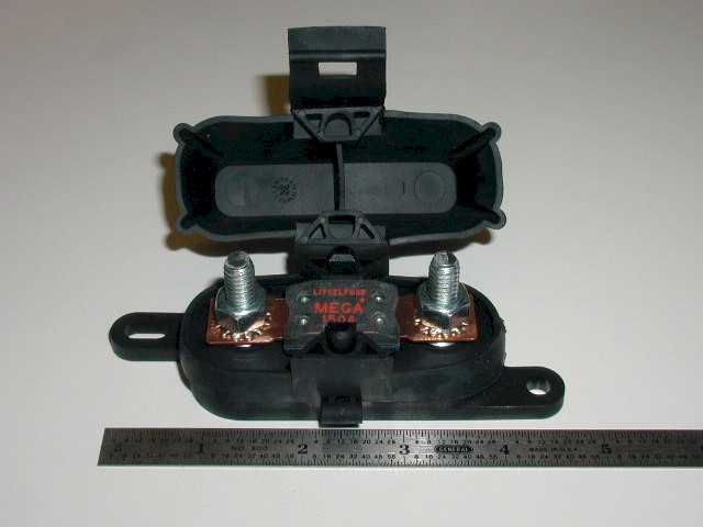

Steve,
I got a lot of ideas from CruiserDrew's dual battery install and used one of these from Hellroaring Technologies. The fuse holder and fuses are available other places. I bought spare fuses from NAPA but I don't think they have this particular fuse holder. CruiserDrew installed this fuse on the ground side of the backup battery. I installed this fuse on the +12v side because I have a high amp circuit going to the rear of the vehicle.
"For high amp circuits such as the backup battery setup, we have available a fuse (150 amp) and fuse holder set. Order part number FS-150A."
-B-

Other than connecting the main cables wrong on the back up battery what is the fuse going to do?
Maybe keep the power cable tying the two batteries together from causing a fire due to minor grill bending accident. Look at how the cable to starter is routed. It is well away from exterior sheet metal. Look at how folks route the cable between the two batteries - stretched across the front of the engine compartment, pretty much in harms way.
