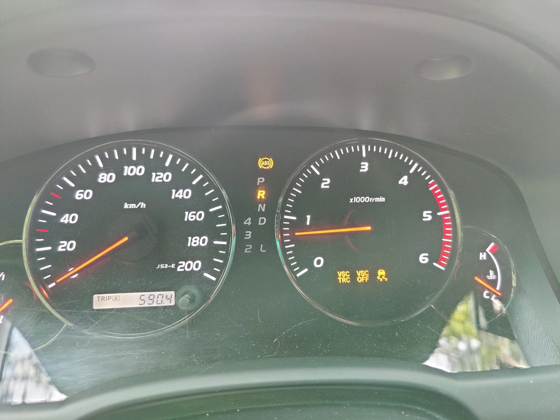

So. It's an automatically 120 with the common 3L 1KD diesel engine, 130k km, overall in excellent shape. Last year while driving it, I noticed that hitting the brake pedal would faintly light indicators related to being on reverse gear : the little "R" on cluster panel (where all gears have their light indicator (P-R-N-D-L-2), as well as the red diode for "R" on the shifter plate, and finally, it also faintly lights up the actual reverse signal light the rear. All brake lights work normally. The reverse light also works normally when in R position. I tried all likely culprits : trailer socket is clean and un hooking it in the left trim in trunk does clear that behavior; all fuses seem ok ; removed the brake pedal switch and disassembled + tested it with my multimeter, didn't look shorted. At some point (explanation below) it lighted several lights on the dashboard : VSC TRC, VSC OFF, ABS, and the stabilisation control one (pic attached). Power cycling the car makes these disappear. The electric "short" (?) between R and brakes is intermittent : sometimes it'll happen, sometimes not, irrespective of other conditions (blinkers off or on, (head)lights turned off or on...

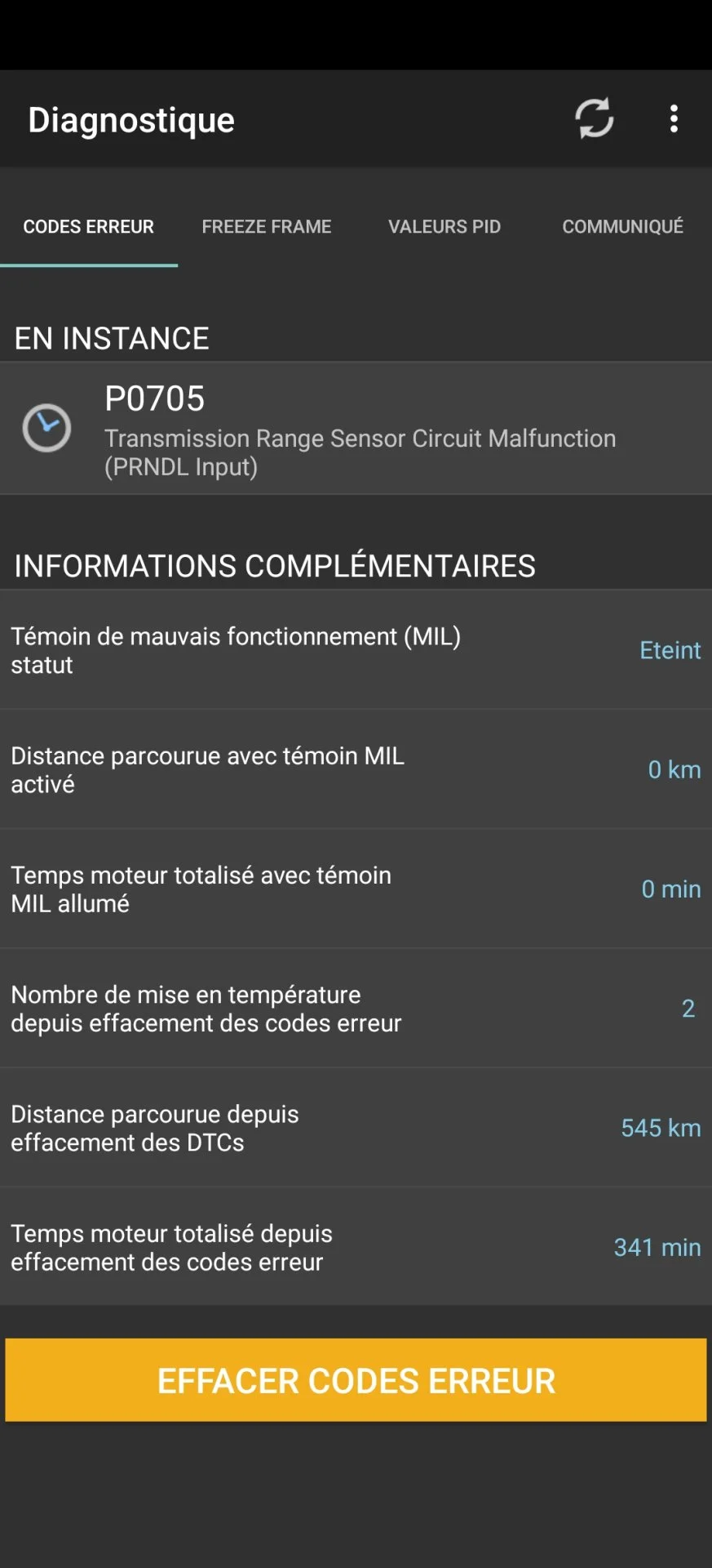

Fast forward to now, I took the car again a few days ago. Without even turning ignition, same electrical issue between brake and R. No DTC at all. Then I put it in reverse, drove our the parking, and there is the Christmas tree on dashboard again: the systematic way to cause the lights to turn on is to 1) experience that electric short and 2) put on reverse and move a few meters. OBDLink showed (see attached, again) :
- P0705 : transmission range sensor circuit malfunction
- C1223 : ABS control system malfunction
- C1249 : Open circuit in stop light switch circuit
Clearing the DTC's and power cycling the car, they remain gone... Until the next episode of short + put car in reverse. The same code are thrown then.

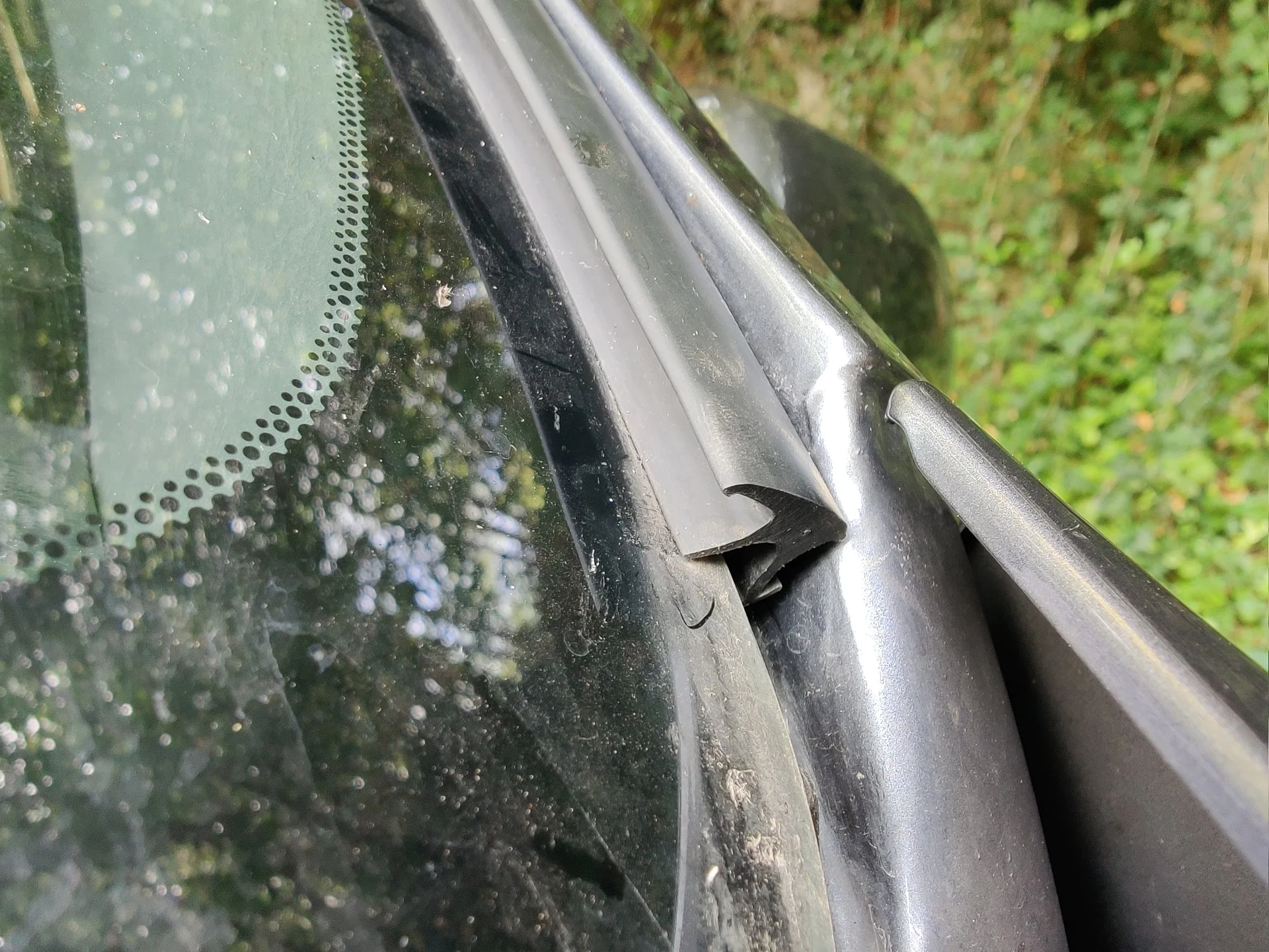

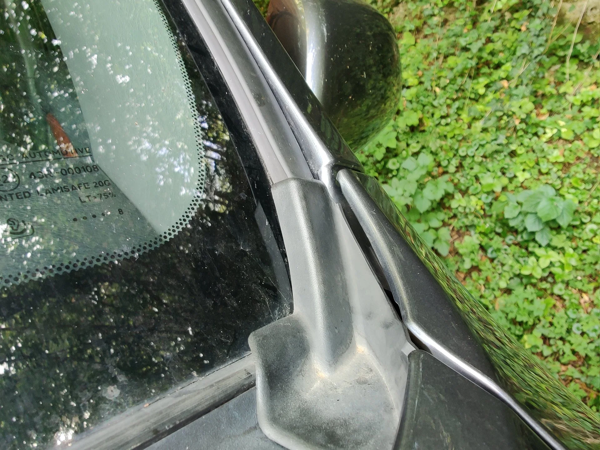

Just had a look. It sounds like it's not like on the 100s with a rubber strip and rivets underneath: I couldn't find a rubber strip to remove.
After removing the plastic part at the bottom, here's what I see.
Re: water/humidity, no trace around the mounting holes on the roof, nor around the sun roof. I'm also not sure convinced by water-related issues because it happened right outside the box where it had been sleeping for more than a months. Pretty much like last year.
