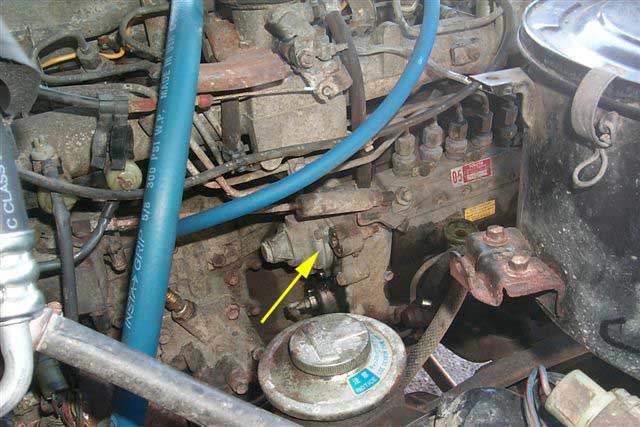

just coz it's easy source the pic .. been asket several times ..
Thx Tapage, but that doesn't look like mine. I have the auto transmission with no edic. I don't see that screw there.

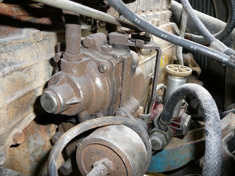

here is a 12H-T IP .. it does not matter if it's auto or manual .. at least with the 2H ..
Maybe you have the IAC as mine .. in this case turn out the compete IAC ..

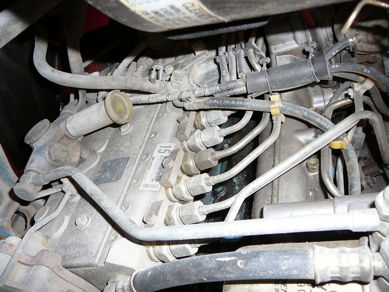

Here is my IP
