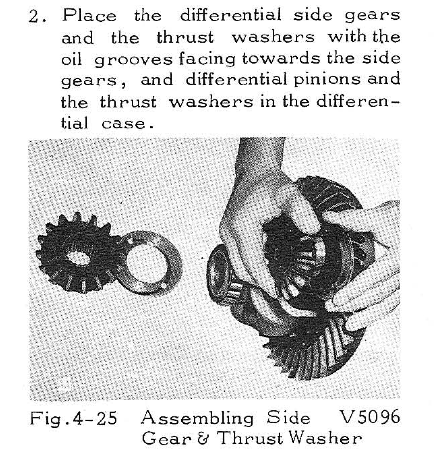

I'm installing an aussie locker in the rear diff today and want to be sure about how the thrust washers go. One side of the washer has an off center circular groove, it was facing the back of the axle gear, is that correct? Or does it matter?
forgot I had a chassis/body manual, found it:
