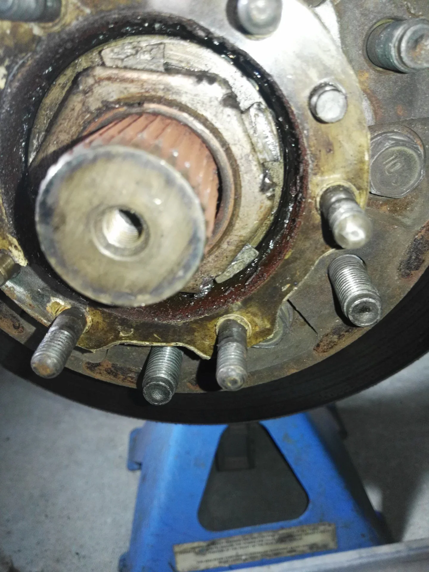

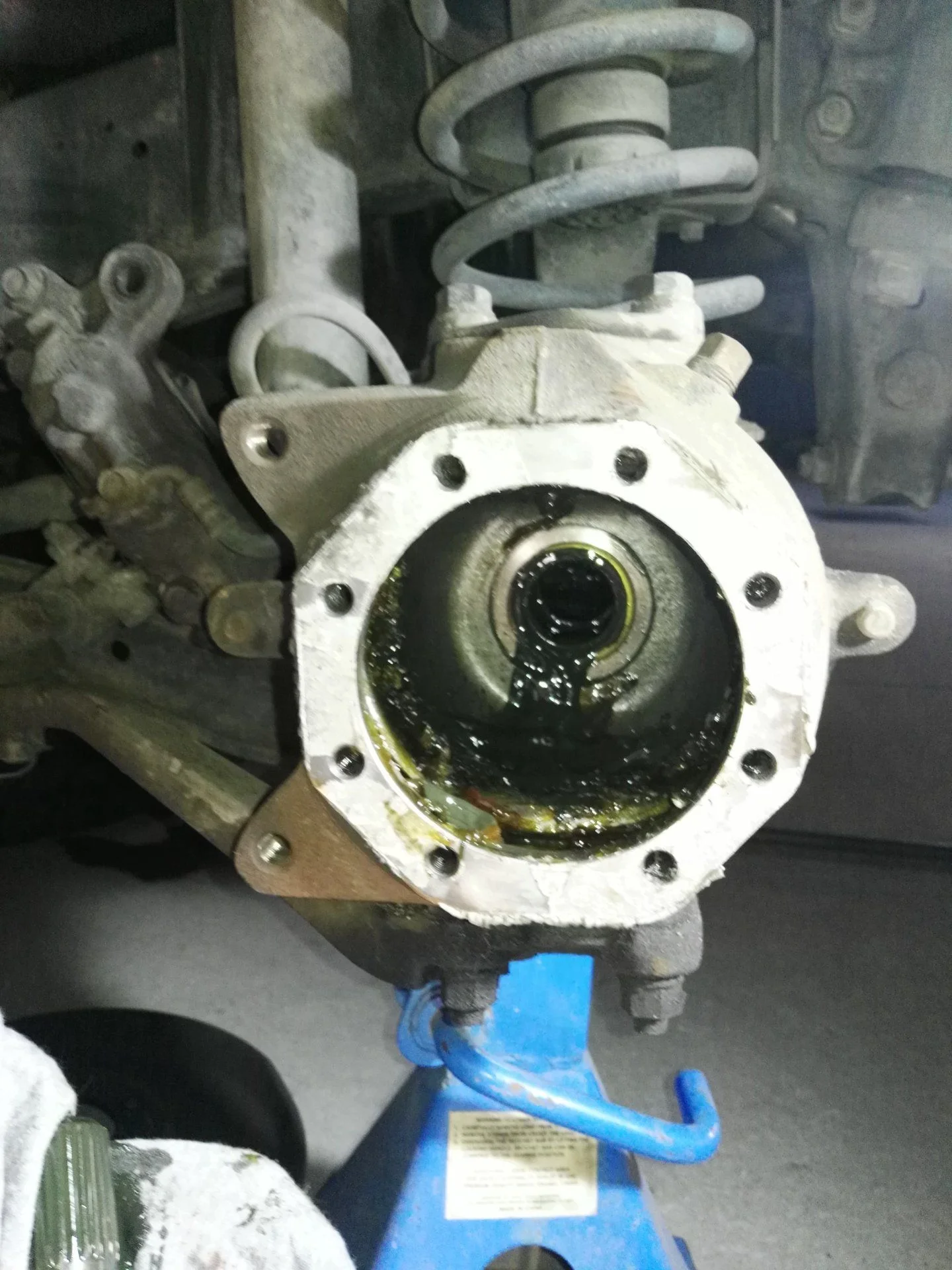

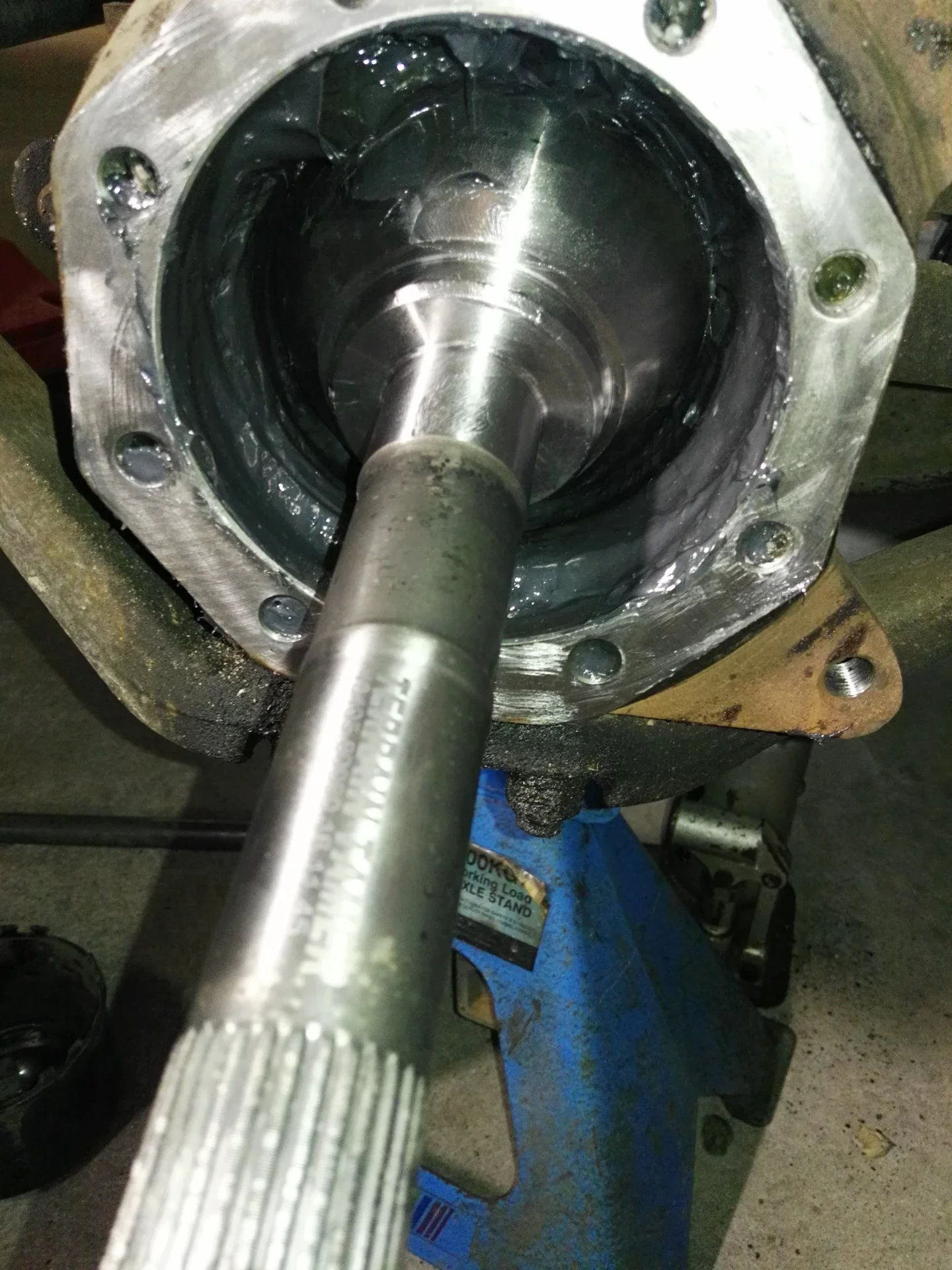

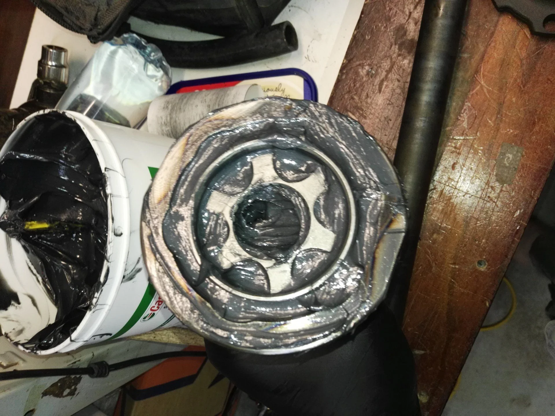

Finally got around to changing clicking birfs, and flogged out drive flanges with some help from my lad.
Some crappy work by the PO to deal with!
Hub nuts have previously been butchered with a chisel, locking tab had not been bent in or out. Hub nuts were able to be undone with the 54mm hub nut socket with barely any torque.
Birfs had almost no grease in them, and next to none packed in the knuckle
This is how we found them.
The diff oil was thick like grease, it took ages to drain out!
Packed new birfs with lithium base moly grease, packed the knuckle with grease too.
Packed a bit more grease in after the birf was back in.
I used a zip tie around the cclip on the end of the axle to compress the clip to help get it into the birf.
I slipped the axle into the birf up to the zip tie, then stand the whole thing up on end, lift it up, then slam it down on a block of wood to seat the axle in the birf, then clip the zip tie off.
Makes it easy to get the axle seated in the birf.
