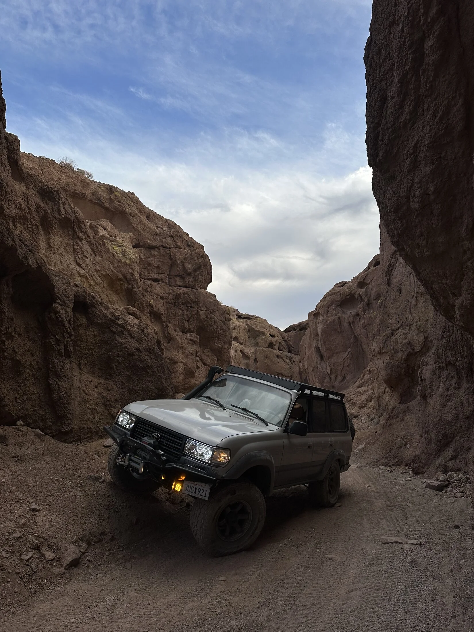

I parted out a 1993 FZJ80 with a blown engine and decided to buy a dirt cheap 97 that I have built up so I basically got a set of locking axles, wiring harness and locker ecu for free. I have had them sitting out for a while but today I finally took the truck out to hit some trails for the first time in Calico California and let me tell you. I FELL IN LOVE!
I'm on 315s and the truck did not struggle one bit, but there was a trail I wanted to hit but I was told I would need lockers or someone to winch me, so I'm going to swap them in now.

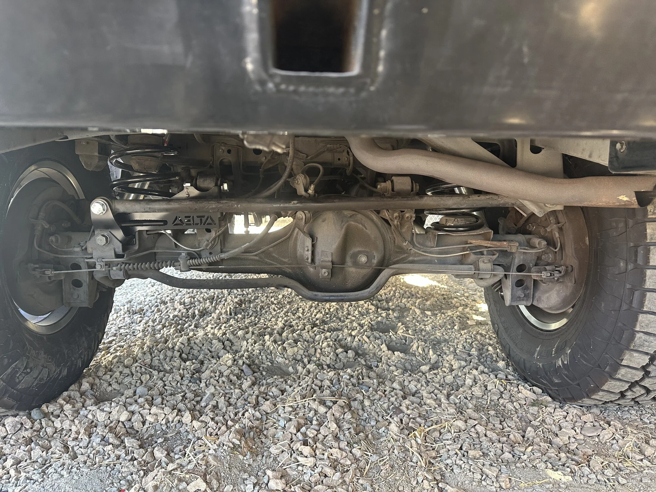

The 93s have probably around 400k miles and no history of maintenance. what should i do before installing? Was going to regear to 4.88s but not in a rush for that. been driving the truck on stock gears on 315s, fully loaded and its been alright, some struggles on steep hills but no rush to regear.
So is there any tips for doing this swap?
What should i change on the axles while they are out?
is there any concern for how high the mileage is?
and finally what would a set of non locking 97 axles with 210k miles and no rust be worth? since ill end up selling them after the swap.
*pics of my truck today and the 97 F/R axles for reference. *

On the fronts, rebuild the knuckles, check the spindles for uneaven wear. Might as well pull the thirds and change the pinion seals. Check the ring and pinion for back lash and end play, adjust as needed per FSM.
I put 4:88's in mine and I'm only on 33's. Amazing slow control off-road and makes a huge differance hauling trailers.
There is a spray dye penatrant that welders use, you might want to use on all the welded flanges, to check for cracks around them. Cheap insurance.
IMO at 400k on them you should just do the gears now with a new install kit that way everything gets a refresh. If there the originals the birdfield are going to need to be replacedede, I would hate to do a knuckle rebuild only to find the burfield's clicking.
You need to check the drive flanges for ware as well as the spindles, the rear one's are not replaceable so pay close attention to those.
New axle seals front & rear
If it was me I would replace all knuckle/drive flange hardware to include cone washers.
As Rusty Marlin suggested check for cracks especially around the front control arm mounts.

Your axle look clean probably $1200 to 1500 for the set.
