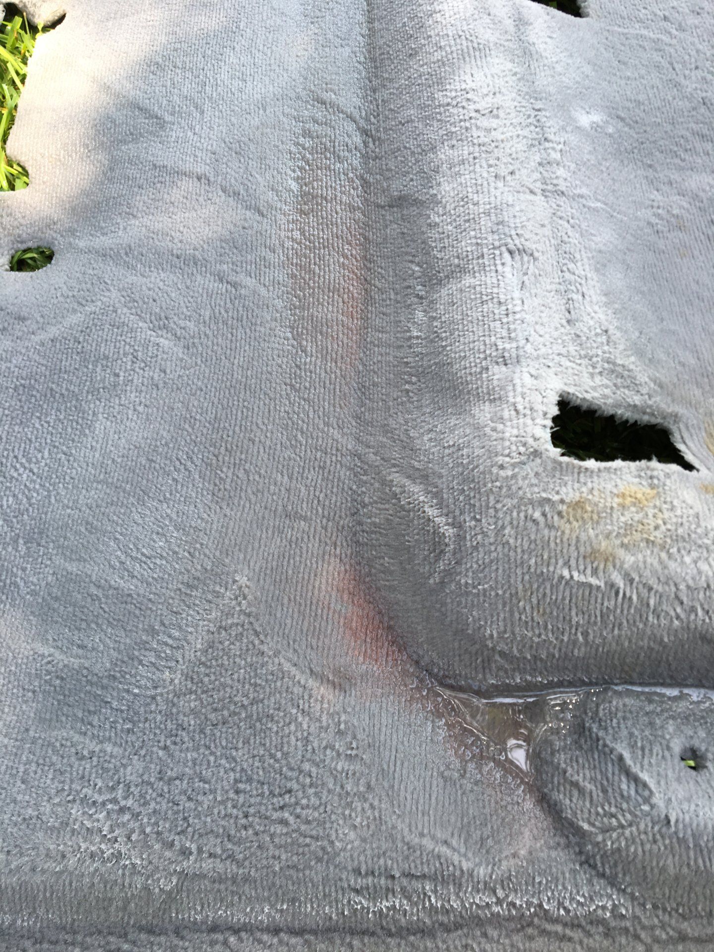

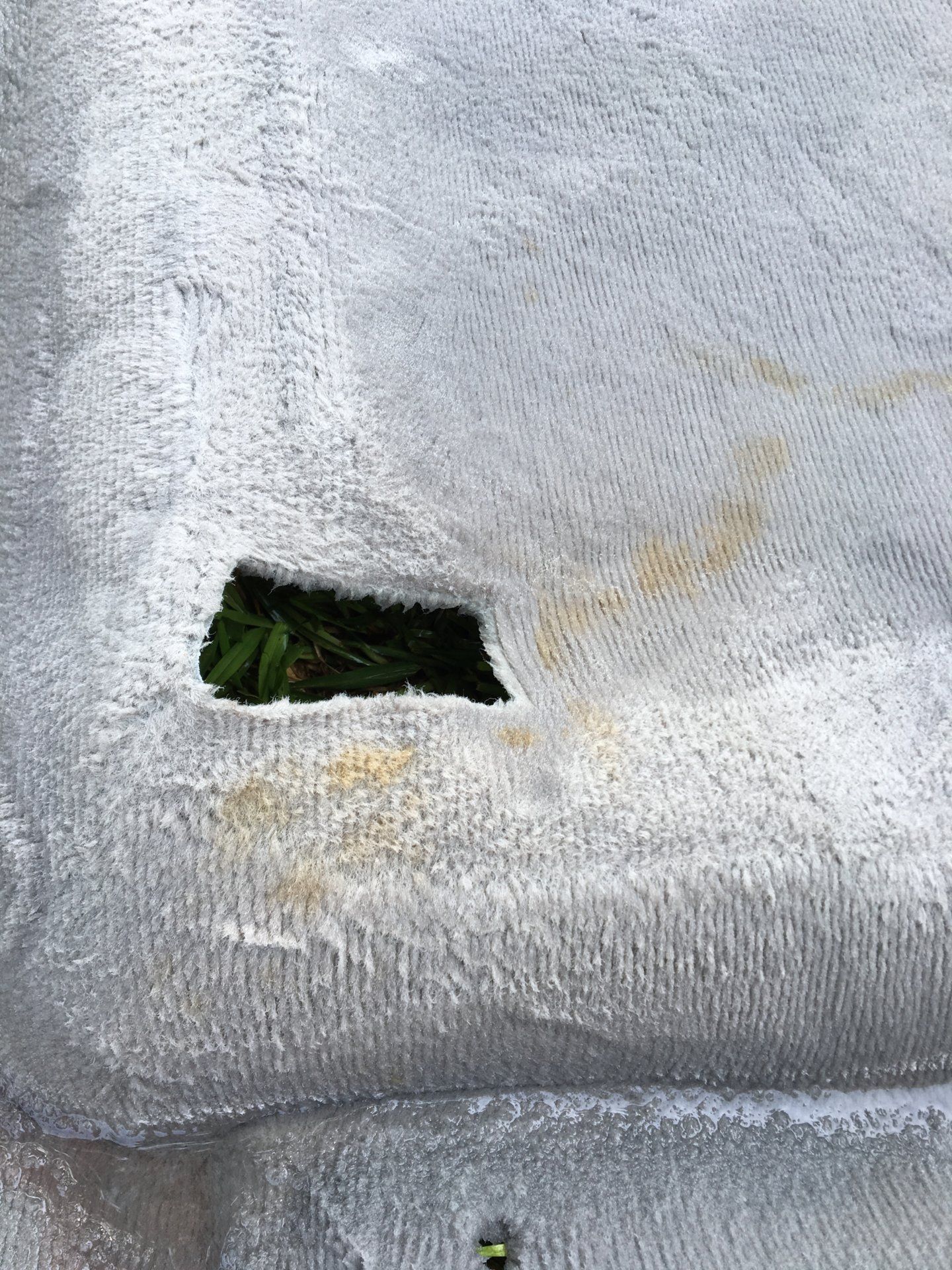

Even after every combination of Purple Power, Tuff Stuff, scrubbing and power washing I could throw at it, these stains in my 100’s carpet have defeated me. The rest of the carpet is much better after my work but these three areas are unfazed. Any ideas?
Any opinions towards aerosol dye products? These are not high traffic areas. The nastiest one is between the passenger seat and console so it’s hardly even visible.
Get some aerosol fabric paint and just go to town on it, it’ll be a little more rigid after but it’ll look and feel clean.

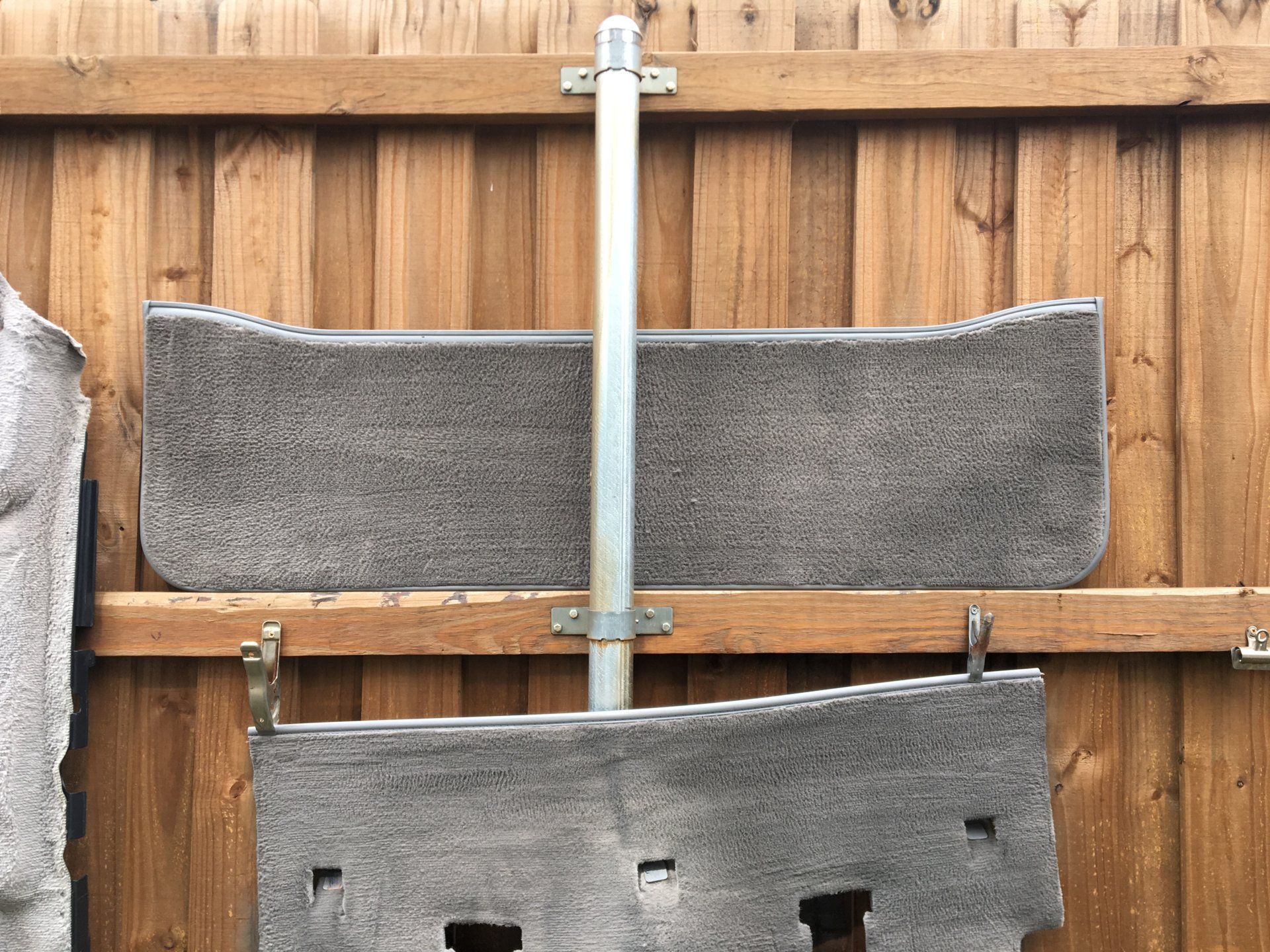

After consideration, I think I’m going to have to go darker to cover the stains. I grabbed that can of “medium gray” and went for it. I’m pleased - though I need a couple more cans and will need to work on the uneven areas.
My approach was to brush the carpet, spray it and then brush it some more to (hopefully) work it into the carpet. After it dried, I brushed a little more to soften the carpet.
Just air it out for a couple of days, definitely don’t want to breathe that smell inside the truck. Looking great

The gray "paint" looks much better than I would've expected. Nice work!

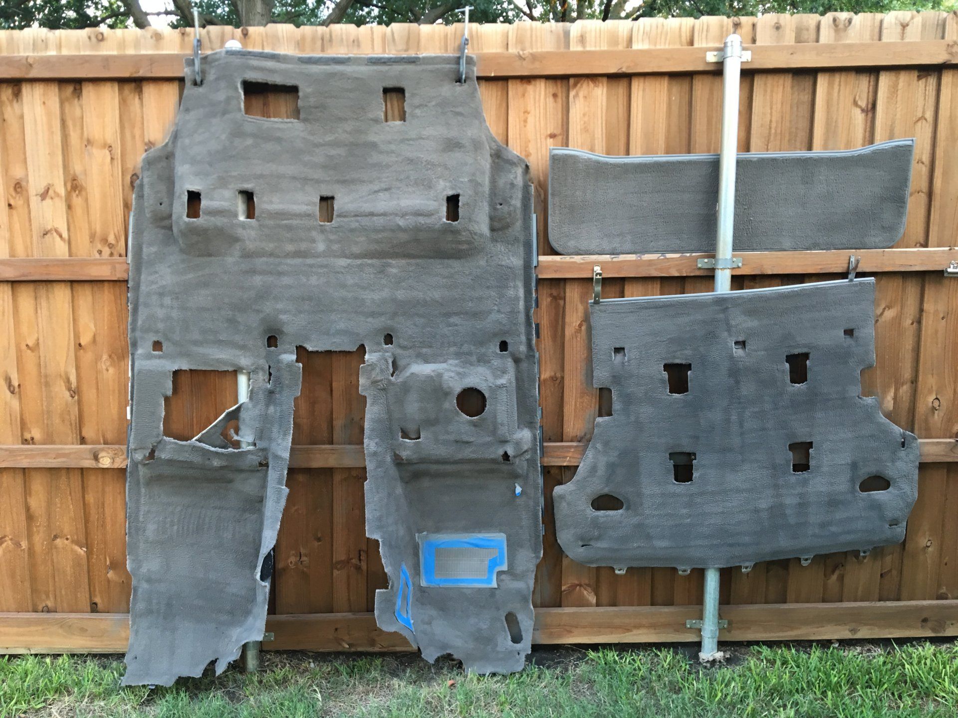

I’m pretty happy with the way it turned out. I still need to work on a spot or two but the darker color hides all.
