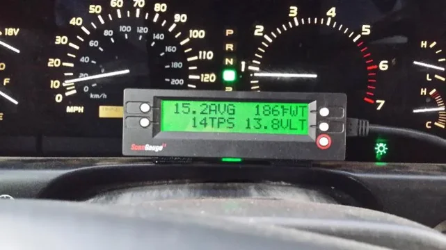

Tried adjusting it today. It sits at 14 now but if I try to go more it seems to not want to idle. I must have this installed wrong, still adjusted wrong or a bad tps. I am going to need to Install and adjust the FSM way.

Cold idle:
Cold idle:
I appreciate you posting up the pic. I am actually looking for the TPS reading like this:
This was hot, coasting about 2 mph.
