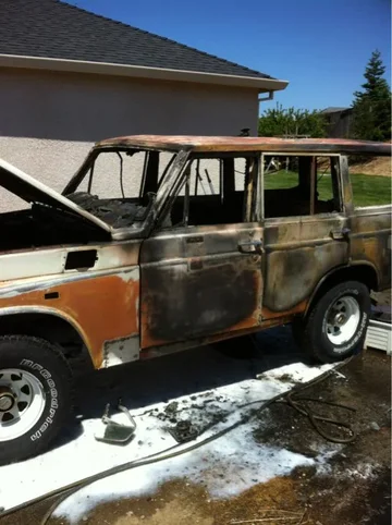

I repeated your experiment on a chunk that Ige fetched from the Green Pig's roof yesterday...mine burned quite well.
Something else to consider...asbestos probably cost more than jute. Just saying...
Do you want to know if the headliner burns ? I am considered an expert in some circles :)
I think she's right that it's jute, but just thought maybe they could have added asbestos fiber for its fire resistance. Apparently it was added to many products back then.
Since your test burned well and Gonzo's inferno suggests it's not fireproof, I guess that's positive news. I always thought that my headliner was original, it was a one owner pig prior to me. Maybe the headliner and matting I have was replaced?
