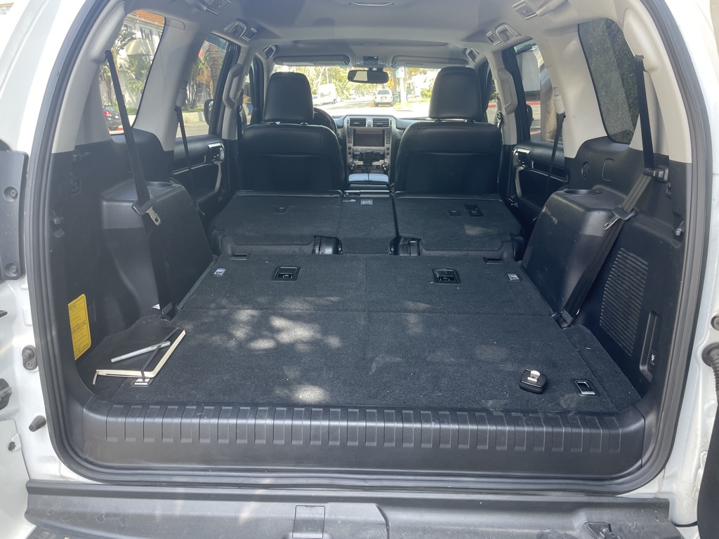

Heya folks,
I'm a GX470 guy myself, but I'm working on a version of the GXBasecamp.com platform for the 460. Since I don't own one, I'm reliant on careful measurement from folks with whom I can meet up to take a look at their vehicle. I had the opportunity to measure out a 460 and designed the platform build off those measurement. But it occurred to me yesterday that there may be differences between the years and/or trim levels that I'm not aware of.
Can anyone help me confirm or deny any differences between to be aware of?
Here's the one I was able to measure:
Thanks!
Like SouthTxGX said should all be the same... one other difference but won't affect you product is the rear left Mark Levinson subwoofer and speaker grille within left fender plastics but that still all keeps dimensions the same on rear left side.

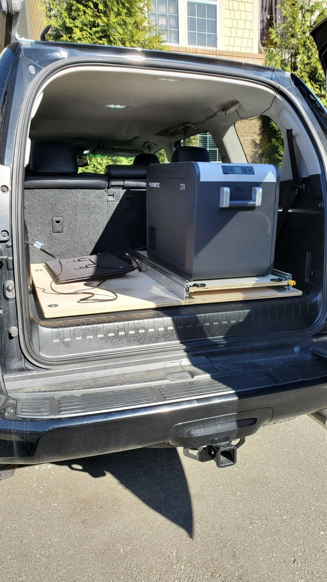

This is what I did. the main platform is 42x36. it is bolted to the back of the 3rd row seats and to the floor rings. I removed the hook rings and there is a 6mm nut that I bolted the platform to. it does pretty good. not the most bullet proof but it will do for now. made my own fridge slide that doubles as a table when fridge is not on it.
