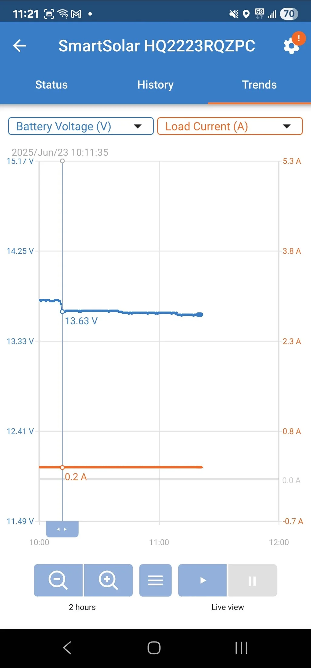

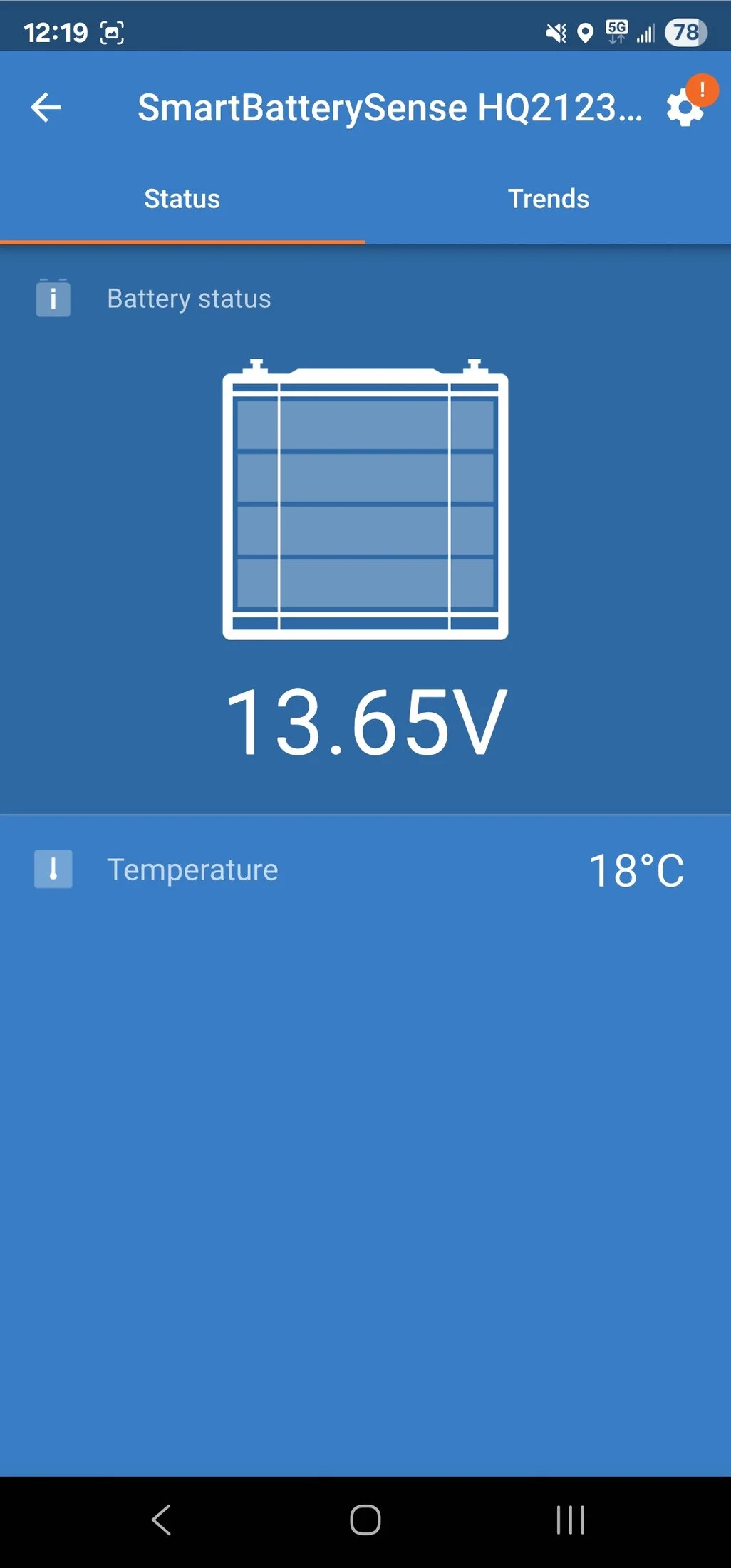

I looked at the trend overnight and as the sun went down, the battery voltage dropped off to 12.74v overnight and that is with no load on it (aside from whatever power the charge controller pulls when it's dark).

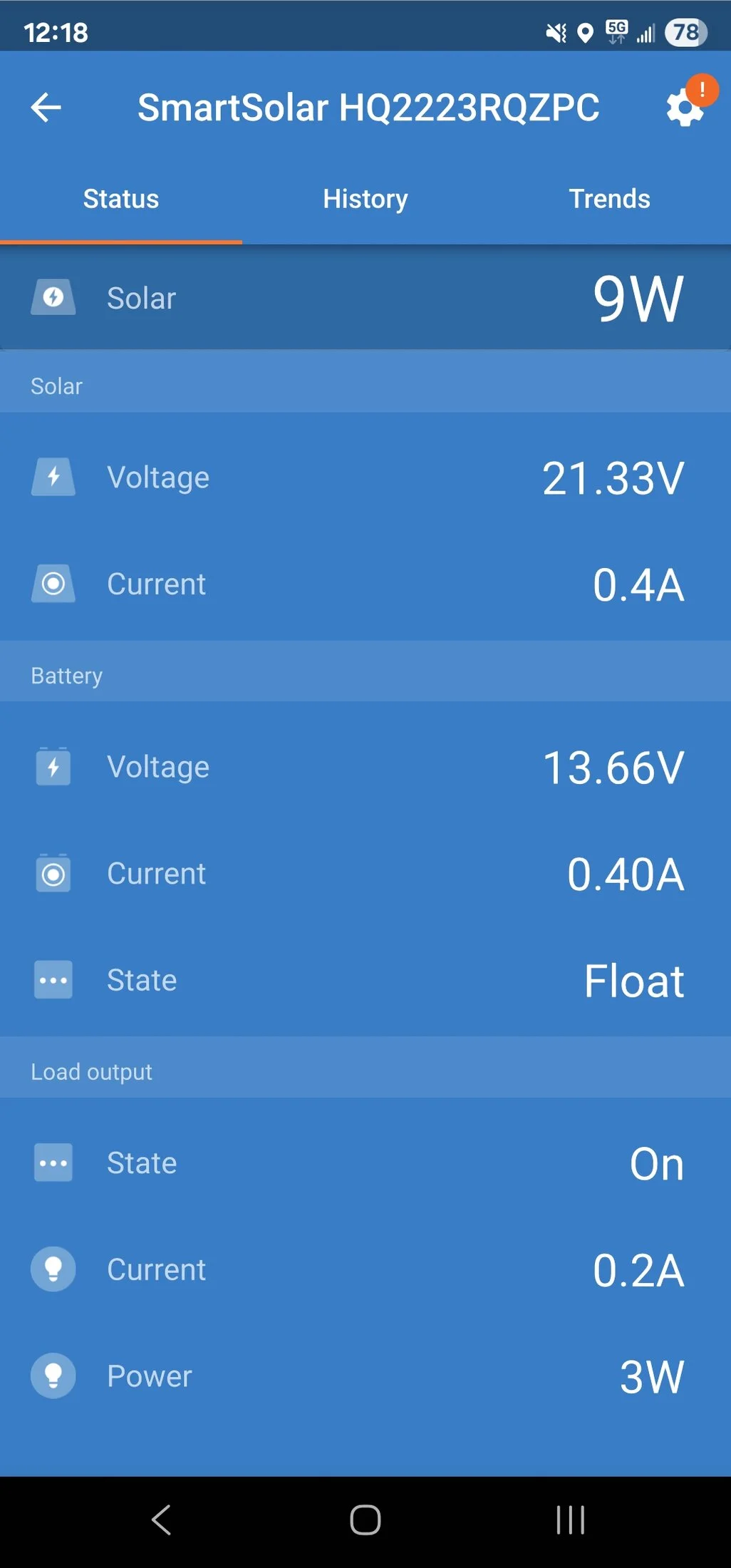

When I looked at the trend from noon-4pm there was a bit of current draw fluctuaion, .2 -> .3 amps. but the fridge could have been pulling 4 amps at that time to get the compressor to kick over and there was plenty of battery available.
For the solar trend over the time the solar was only putting out 2-3 watts, however this morning when the sun came up and the battery started charging, it was putting out 14 watts (no load on anything). Looking at the history, 2 days ago, it was outputting 120watts, but that was when daytime temp was over 100F and the inside of the truck was likely 120F

^^ you'd want to check the battery voltage under load, but 12.74V overnight with no load is excellent. That means a fully charged battery voltage at rest. (It is possible that the battery would have low capacity and show good voltage under no load, though, but not too likely I would think.)
If you meant 0.3A from the controller to the battery, that is very low. If the battery is fully charged and the fridge pulls 4A from it, the solar controller should compensate for that quickly and then provide the 4A in turn if there is enough insolation, so it keeps the battery charged. You should readily see that.
14W of power is not much. If that is when the fridge was not running, then it means that the battery is likely close to full. Or that there was little insolation if early in the morning.

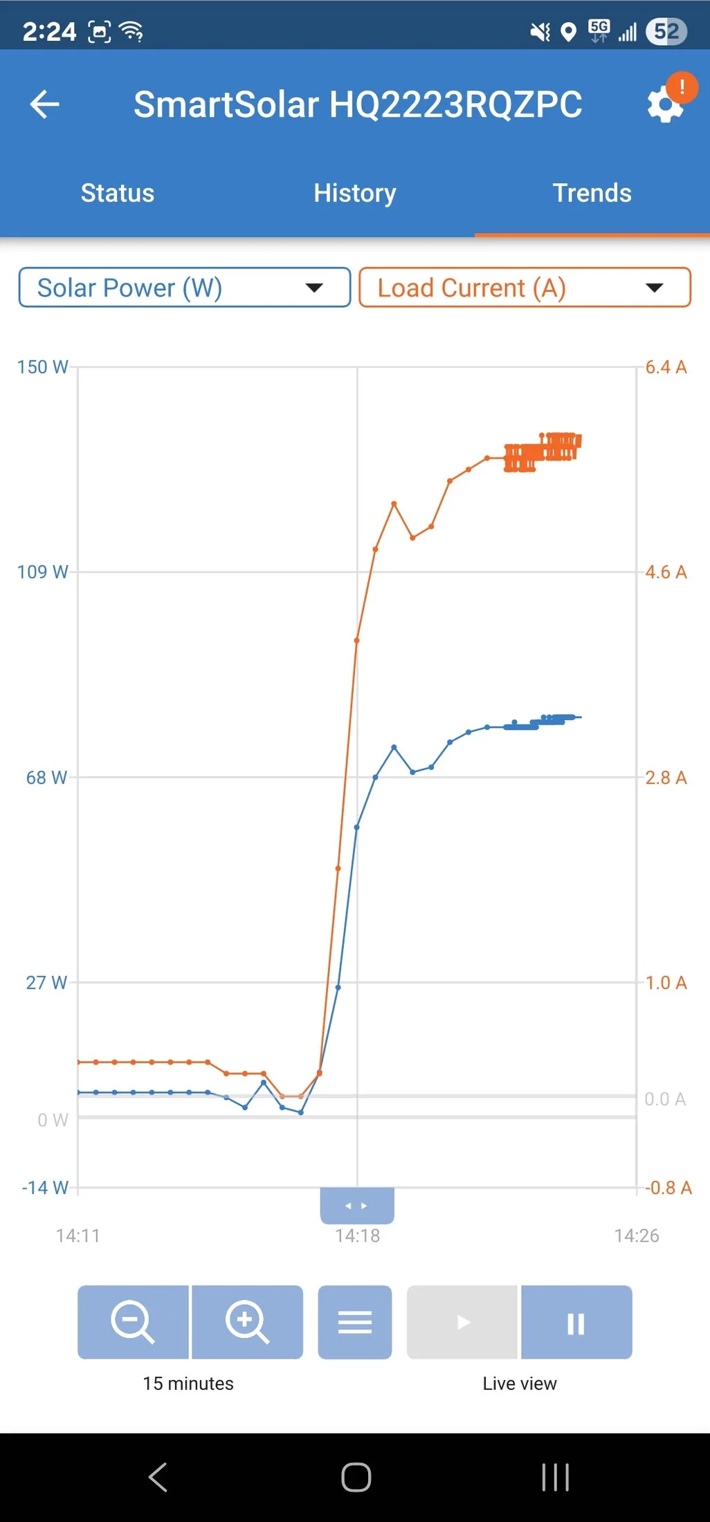

Here's the screenshots.from the battery and charge controller.
The batt voltage has nothing to do with what the voltage is at accessory. The fridge transforms the 110 to 12v so it has to be something in the supply line, I think you have eliminated the battery as an issue. Forget all the equip. and hook the thing straight to batt and see
I bypassed the fuse block (theres a big fuse on the battery and another on then fridge itself) and now the fridge is pulling the amperage I'd expect.

I would be checking what voltage your fridge is seeing. I say that because I had my ARB fridge wired up pretty similar to yours. I had a blue sea 12v outlet wired to the load output on my Victron Smartsolar 75/15. Victron says the load output is rated for like 20 amps, so amps were not an issue. The main issue I was seeing on my ARB Zero fridge was the fridge was seeing a lower voltage that what the battery was at and also what the victron app was showing. I can't explain why it was seeing such a voltage drop but it was causing my fridge to go into its low voltage protection mode and shutting off.
When the engine was running the battery voltage was higher and the fridge voltage was still lower than the battery but not low enough to cause any faults.
I wired the fridge outlet back to the blue sea fuse panel instead of the load output on the Victron and didn't have the issue after that.
I do not know why the Victron MPPT was causing such a voltage drop even at a small load like a fridge.

Looks like you have the fridge on the load output of the controller. It's good to have the voltage control there, usually, but it is also more likely to be a problem than connecting directly to the battery. If the fridge draws a lot of current on startup, the voltage at the fridge could be lower than what it needs and it could shut off. And you would likely not see that on the Victron app because it is a very short event. That issue could then be worse if you have the voltage drops on the fuse block, fuse etc, which could explain what you just saw.
Alternatively, it could also be that the disconnect voltage setting for the load output on the controller is set too high, and it would similarly shut off the output on startup.
