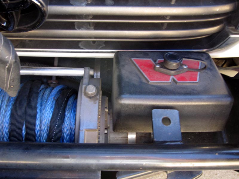

Sorry i was not clear in my question. Can you post a photo of how the winch is bolted into the bumper? Did you need to clock the clutch handle?
Thanks
Dave
The m12k just fits as is - feet forward, nothing to 'clock'. You do relocate the winch control module (where the solenoids live) using a provided ARB bracket. Otherwise it's all just plug and play.
cheers,
george.
The arb bracket
Offset hawse for ARB
