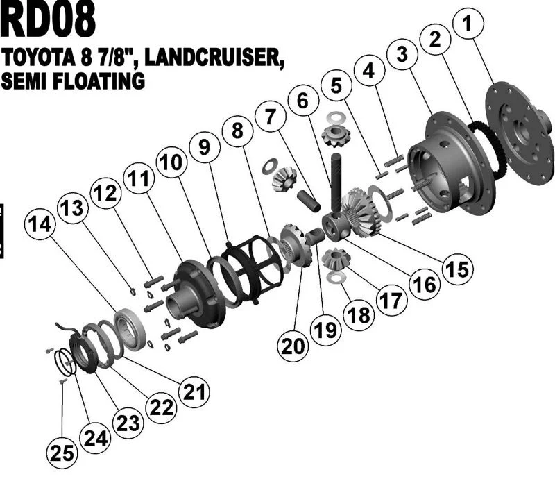

Ok.Thanks. I will look at the drawing and see about ordering some spares. It is probably was lack of use. I need to do more wheelin that requires the locker. :) Maybe just activate it every month a couple of time would keep the o-rings lubed. Maybe the o-rings dried up on me.

I just was reading the ARB manual and says to leak test the locker by actuated the locker and if the pump does not cycle in 15 mins it is good. I am going to try this but I think it will pass. Also in the drawing I see the o-rings and will take pictures and post them if I pull it out.

Looks like two o-rings which are # 24.

We replaced the cylinder cap, u-ring/bonded seal, and used the newly introduced "square" cross-section o-rings.
Nice writeup Kurt.Thanks. When did the new square cross section o-rings come out? These replace the #24 in the diagram above?
They started in LC applications mabey a year or so ago, slowly replacing them in the different applications. They do replace part# 24, aka the seal housing o-ring.
Let me clarify they are not a 100% square cross section o-ring, more like an "x". By design they have two finite sealing surfaces, rather than one like the round. Beyond that, it is much more difficult and very obvious when the seal is "twisted" during the install. Many of the seal housing issues I have had brought to me for repair have been result of improperly installed seals or seal housing. The new free-floating clip style seal housing (new 2-3 years ago) went along ways to preventing that, but the new seal makes things better. Its my opinion that the new improvements aren't necissarily "better" as much as easier to install with less potential for error. Make sense?
