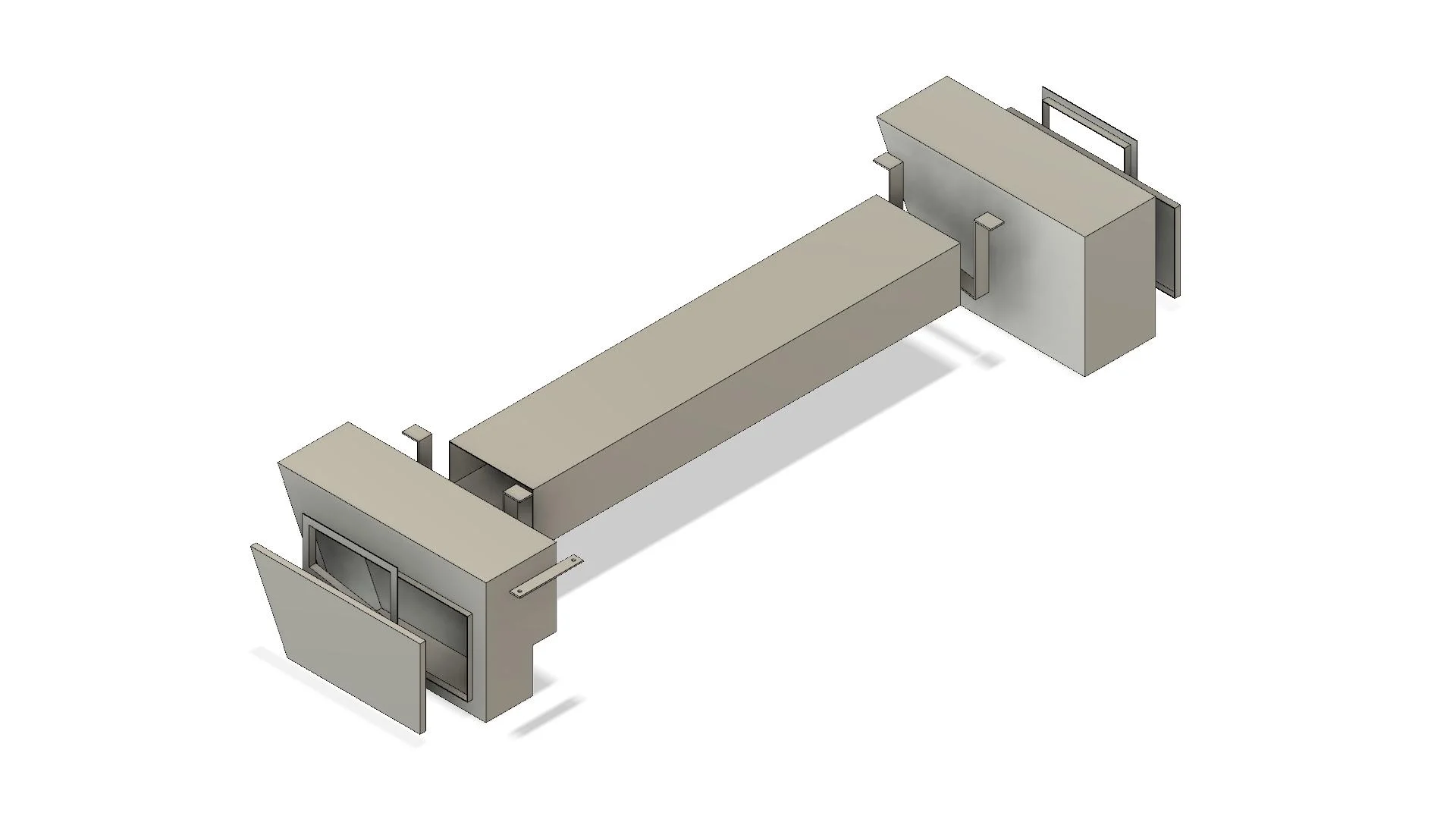

I am designing some toolboxes to mount under the tray in front of the rear wheel.
Something like the attached picture... Does anyone here have something like this and can help with a few questions.
1. What aluminium alloy did you/the builder use?
2. What thickness material did you use? I would like to use 2mm but are unsure if it is strong enough and I should go with 3mm.?
2. What thickness material did you use? I am unsure if 2mm is enough or I should use 3mm?
I'd go with 6061 T5 or T6 aluminum ( aluminium on the other side of the pond ), good weldability and medium to high strength, depending on heat treatment.
On the thickness, if you could bend a couple of ribs into the long flat sides 2mm should be ok, if no ribs then go with 3mm.

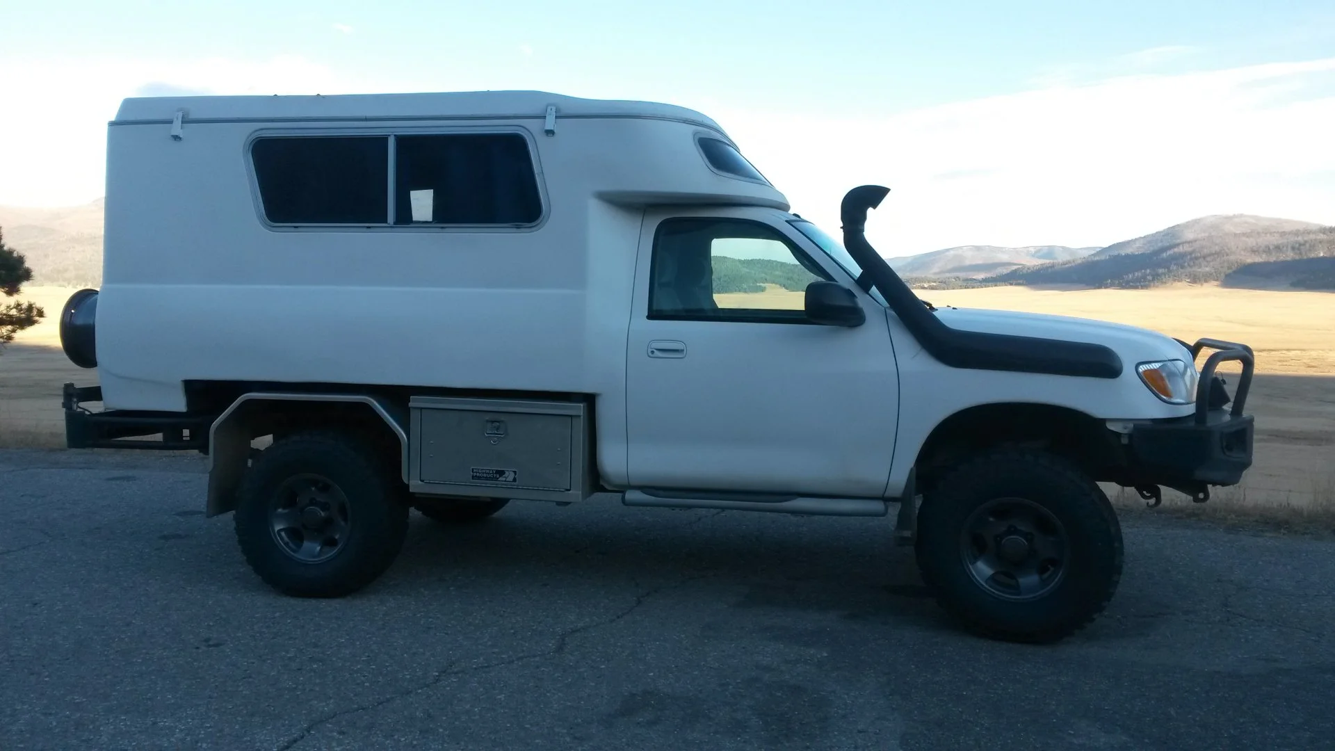

I had two custom aluminum tool boxes made for my camper by Highway Products. They have held up well for 10 plus years now. I think they use 1/8" Marine grade aluminum sheet. There website now says their current boxes are made with "5052 .125" smooth aluminum" Mine were custom, so there may have been other options.
Setups looks neat. You got any build page or more pics?
I do it is on Expedition Portal
