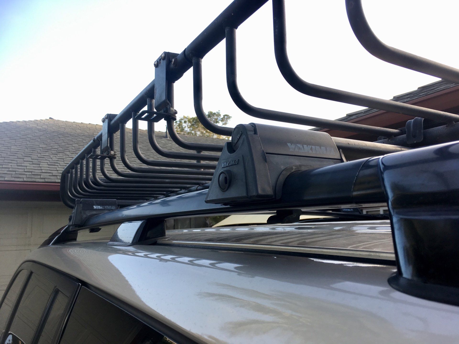

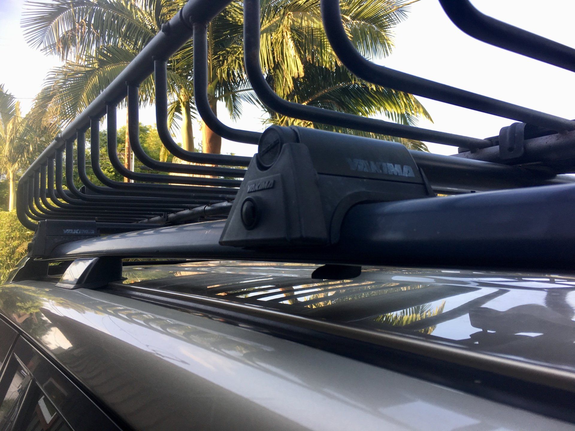

I went with the longer claw - your first link - holds the MegaWarrior on tight. Not a fan of the air noise hum so I don't keep mine on. Ended up getting a long 5mm hex key to make quick work of adjusting the bars, too.
Correct - you'll have plenty of room to adjust the claw under the rail.

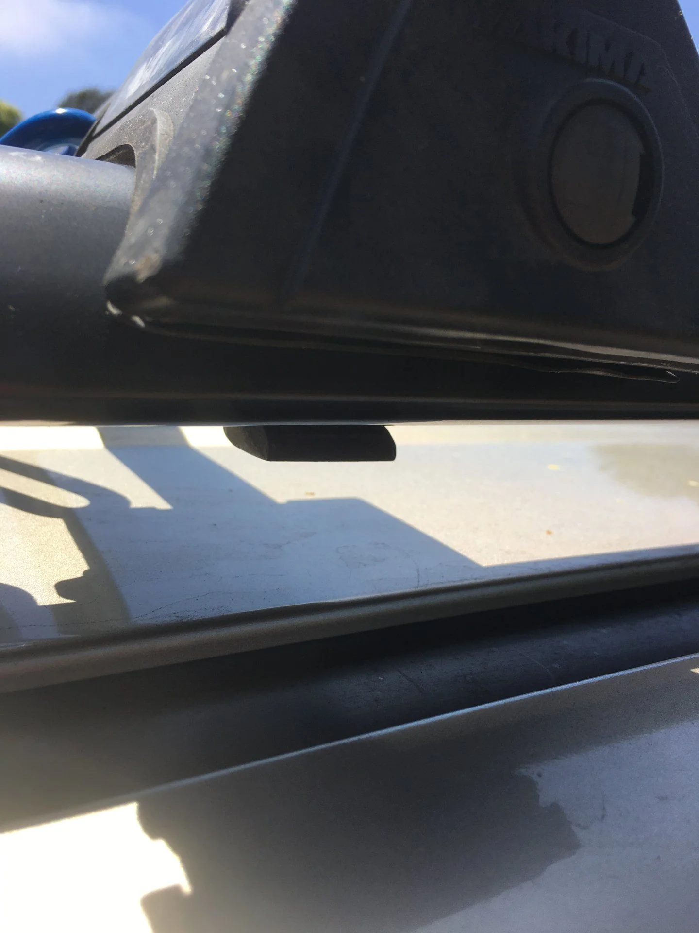

Do you by chance have any pictures of how that connects? I ordered the large claws but then it looks like I should have gotten the mediums. Yakima’s installation guide actually shows the small claws that would go into the center slit in the rail, but I couldn’t get them tight enough.
The large claw grabs the bottom of the rail. My thinking is to get as much meat as possible between the outer mount and the inner claw. Once you have the claw height adjusted, then you're just using your hex key on the offset hex screw to tight and loosen. Easy on/easy off.
I was actually able to install the feet with the small claws, but I agree with you....they need more surface contact. As luck would have it the claws came in today instead of the projected 4 days from now....so I get to redo all of that again. Thanks for the pic and advice!
I use the older style lowrider yak. Pictured below, on both trucks and supporting arb awnings. 10's of thousands of miles on this set up with zero issues. On big trips, i'll add the 3rd cross bar if I happen to need a coffin.
Pretty sure it is the medium claws that fit. The large won’t move far enough up to grab the bar. I tightened it as much as possible and there was still 1/4” not touching and even tightened up all the amway the arch could be pushed up and move.
