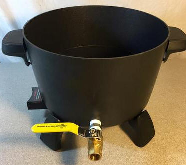

For heating the Woolwax, the guys in our shop made the Presto pot in the Youtube video below. It works awesome. They bought the electric Presto pot in Walmart for like $25.
