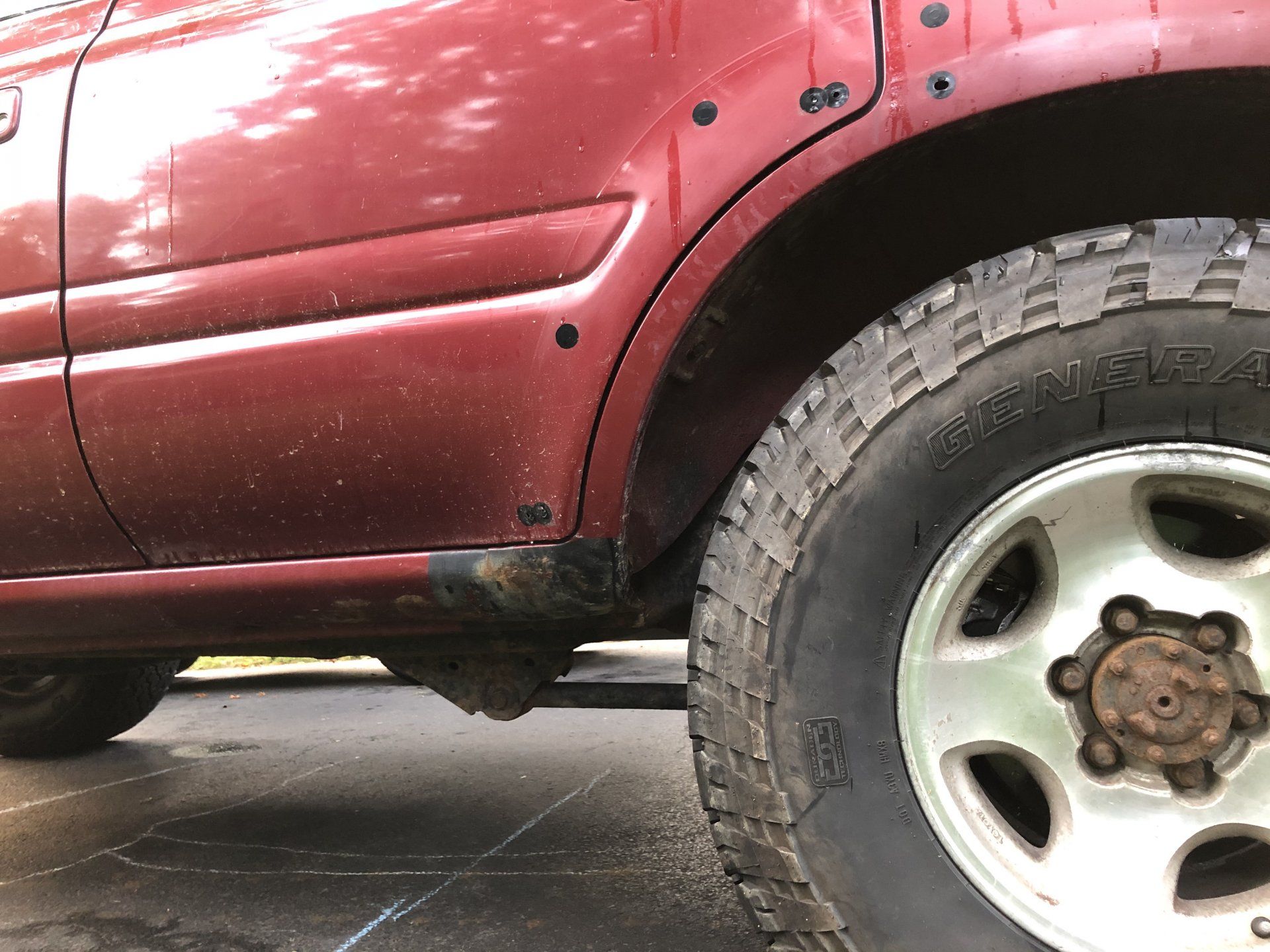

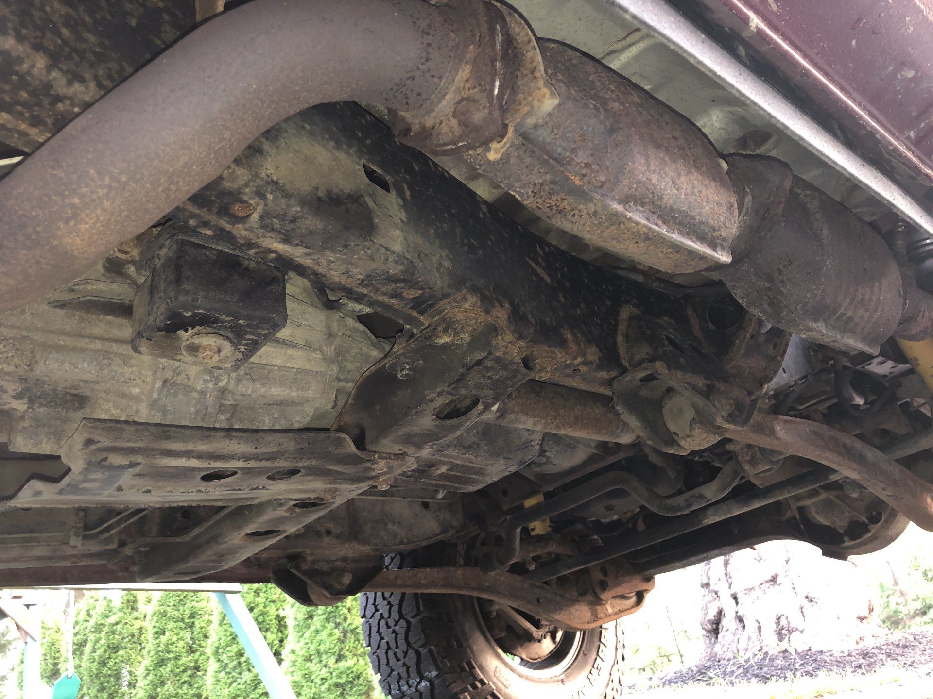

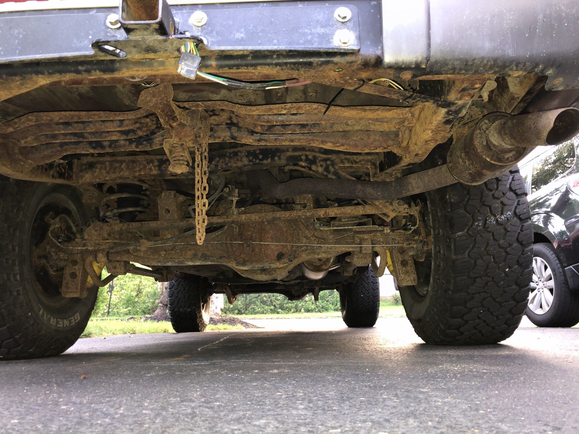

Hey all...recently purchased a '95 that's spent all 25 years in PA. The under carriage looks like it has never been coated (pics attached), so it's really great to have found this thread on Woolwax. I'm in NJ, and trying to figure out how best to approach prolonging it's life. (few pics attached)
Seems that many here may be refreshing previous annual applications of FluidFilm with Woolwax to compare the performance of the two products (and maybe even the ease of application), and would appreciate if you could share your thoughts about applying Woolwax / FluidFilm on a rusty undercarriage that has never been coated before?
In the pics by AbodeOnTheRoad (post #107) looks like the Woolwax was sprayed right over the rust. It looks fantastic, but isn't the existing rust continuing to do it's damage where the Woolwax couldn't reach and the rust can continue to get oxygen?
I'm probably overthinking this, and it may be just a spray-and-forget type thing, but shouldn't the under body be first hit with a grinder and wire brush, then a rust converter application for the areas where any rust remained, and then application of epoxy-prime coating on the frame & wheel wells, and then finally a full spray of Woolwax on everything for protection?
Also, once it's all sprayed with Woolwax, will it be an issue to see future leaks/seepage and do repairs under the vehicle with the Woolwax coating all over everything? I'm not saying maybe keep it unprotected, but wondering if the thick protection layer will make it a problem when trying to work on it.
Just trying to learn before I start down the messy road of trying to fight this long uphill battle. And yeah, I shoulda / coulda / woulda bought a rust-free 80, but sometimes you just get what you get depending on locale and budget and timing.
